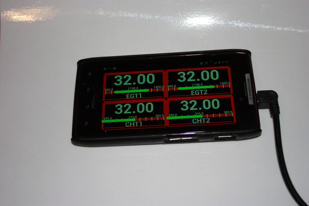

My datalogger in my race car is an Arduino based system monitor that measures multiple temperature and voltage inputs (EGTs, CHTs, AFR, RPM, Throt Pos, Oil Press, Oil Temp).
To measure just 1X Cylinder Head temp (CHT) & 1X Intake Air temp (IAT), I could program a chip the size of your thumbnail to control a variable potentiometer based on a table lookup.
(IMG:http://www.914world.com/bbs2/uploads_offsite/www.jameco.com-10819-1478384056.1.jpg)
You could update the tables over usb to tune it.
To do it right would require 2X miniature thermocouple amplifier boards @$15ea
It could read the two temps CHT & IAT and decide what temp to present to the ECU as a variable resistance output.
If it could also read MAP, AFR & RPM, it could adjust the rich/lean bias in the ECU by moving that CHT input to the stock circuit.
I can plug my cellphone into imy DL and read the temps all in real time:
(IMG:http://www.914world.com/bbs2/uploads_offsite/i366.photobucket.com-10819-1478384056.2.jpg)
