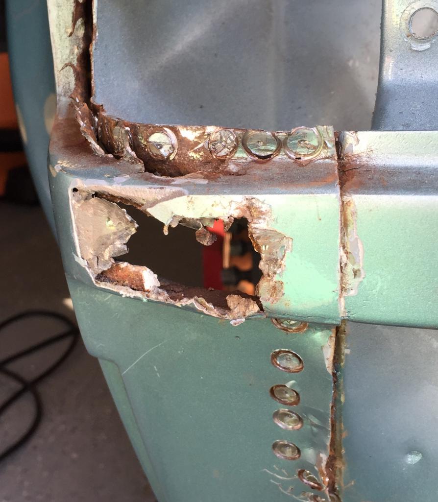

Ok finally removed rear quarter. It's really amazing what you can find hidden
underneath nice paint. A complete chunk missing beneath the left rear light housing.
Popped right out when I flexed the panel while removing. Next up left inner lower firewall. Oh and my "fresh air" elbow was half bondo!?! So this car had issues
