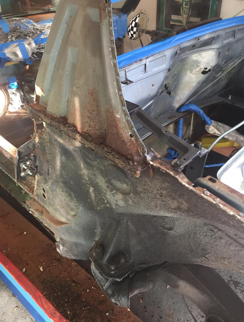

Dion   Ok finally removed rear quarter. It's really ...   Nov 5 2016, 07:15 PM
Dion   Panel off   Nov 5 2016, 07:17 PM
Dion   So this will get fresh paint   Nov 5 2016, 07:22 PM
tygaboy   So this will get fresh paint I love pics like t...   Nov 6 2016, 07:43 AM
