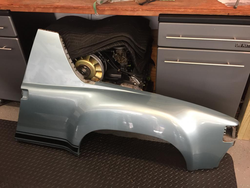

So this will get fresh paint

QUOTE(Dion @ Nov 5 2016, 06:22 PM) *
I love pics like the one above! It's like the 6 is patiently waiting, hiding under the bench. Here it's peeking out and saying "Hey car, I see you! We are gonna have some kinda fun!!"
Keep up the great work!
