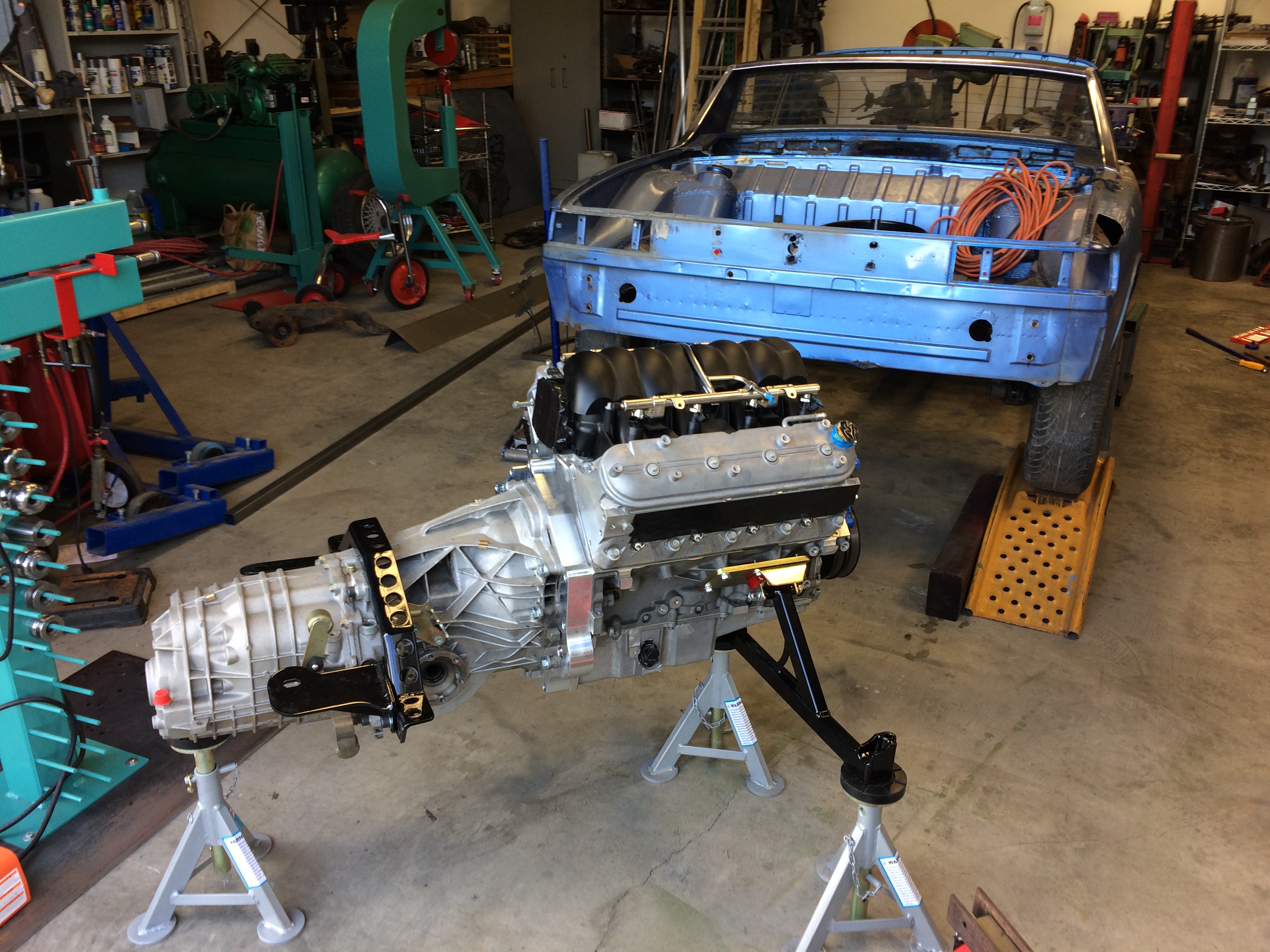

It was a frustrating weekend in that I didn't complete what I thought I could. I wanted to get the drive line mocked in but it quickly became apparent I would need some additional jacking capabilities.
But let's start off with this: I'm claiming the record. Not only is my 914 on jack stands, so are my engine and trans! (IMG:style_emoticons/default/lol-2.gif)
