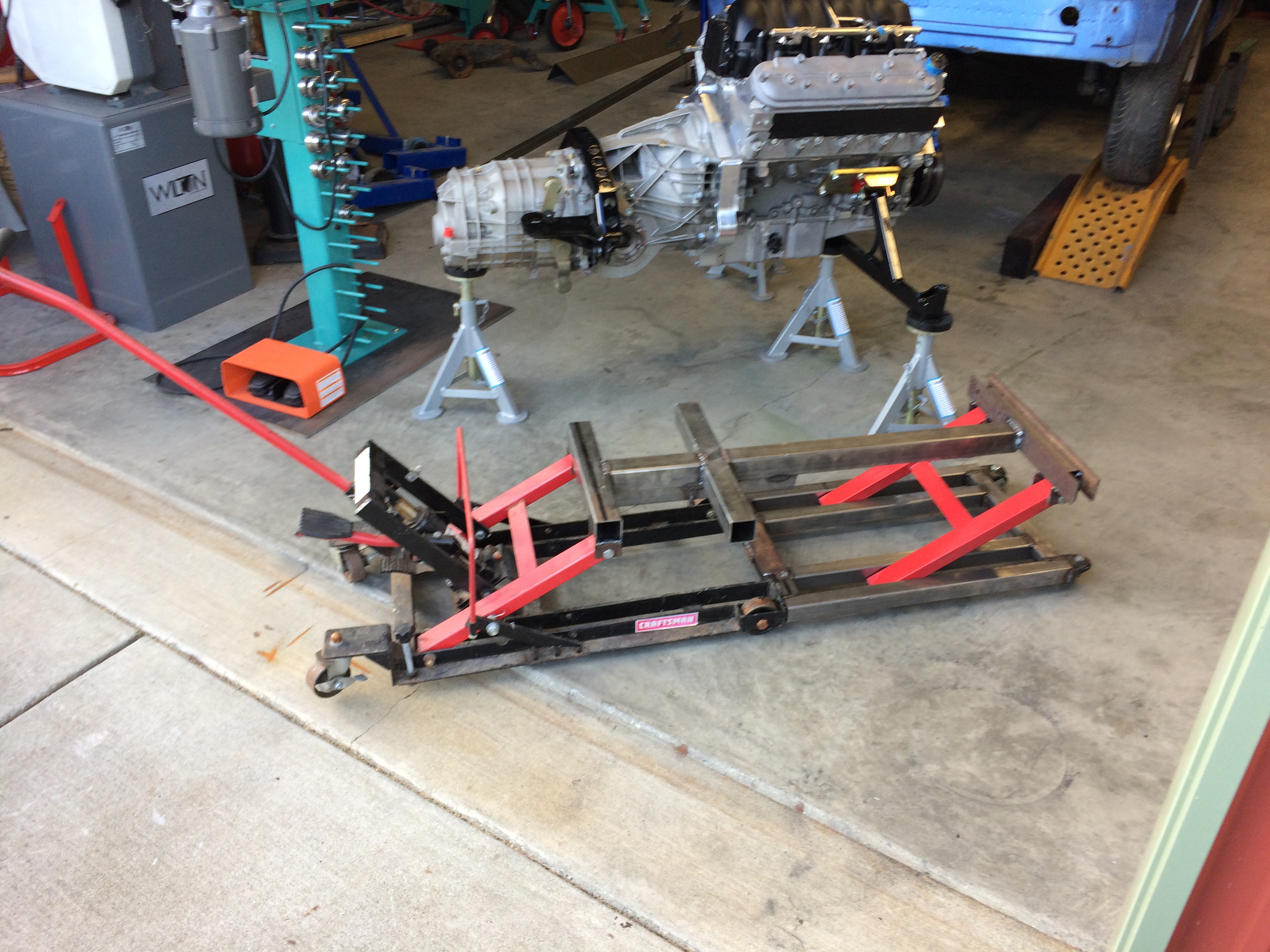

So the only progress to report for this weekend is that I've fabbed up a jack that should allow me to handle the drive train by myself.
Credit to AndyS for the basic design. I went a little overboard on strength but it's the material I had.
So if anyone asks, you better believe "I know Jack!" (IMG:style_emoticons/default/aktion035.gif)
