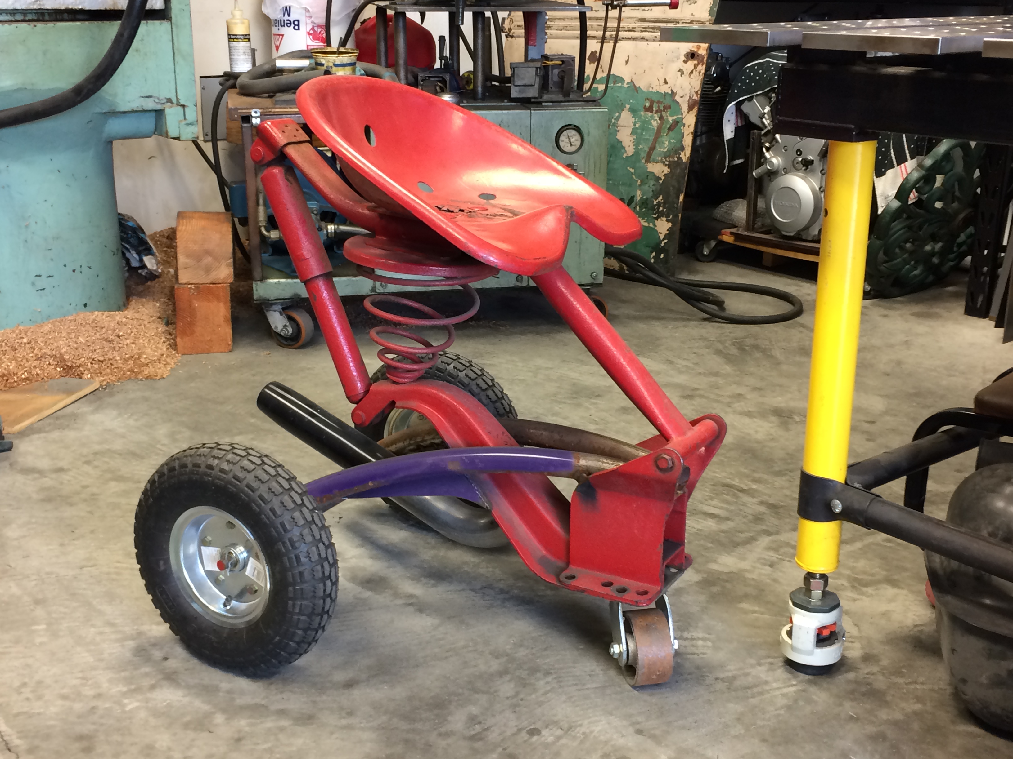

And after all this hard work, I'm adding a little comic relief.
Here's the welding seat I built. Quite comfy with the full suspension!
And yes, that's an exhaust tip from an MV Agusta.
As my wife likes to point out, I'm the only person she knows who needs a muffler on his chair... (IMG:style_emoticons/default/sunglasses.gif)
