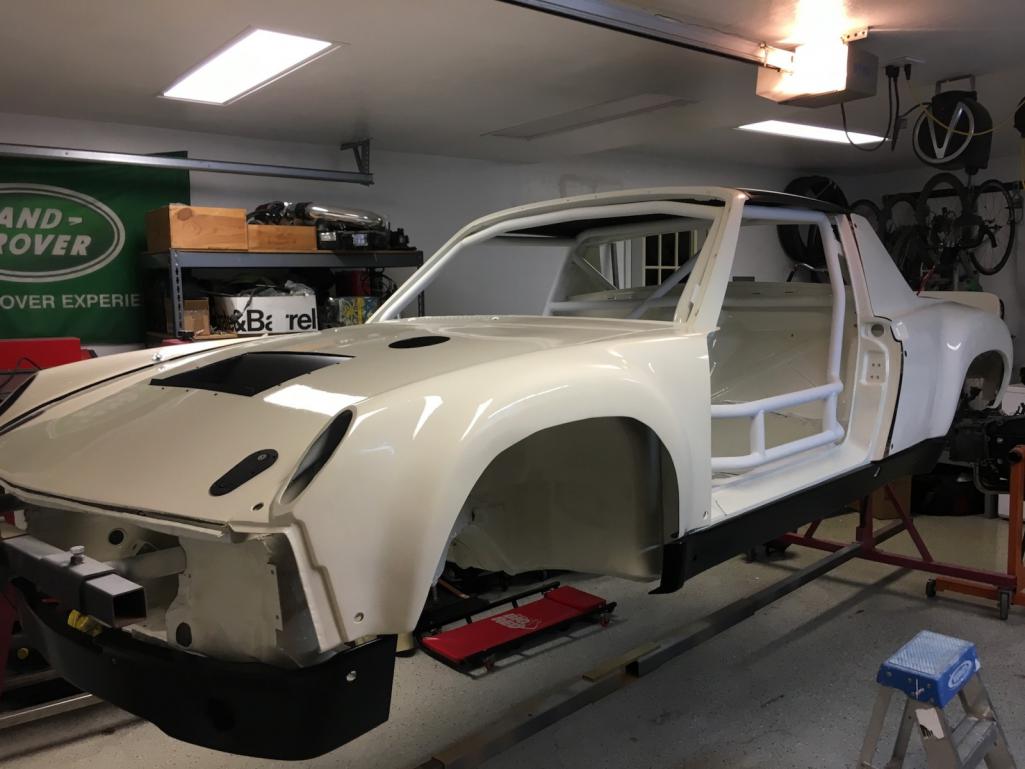

Put some paint on the 914 chassis:
- front trunk
- wheel wells
- rockers
- engine compartment
Painted the black bits (satin black) too:
- targa top
- front bumper and lip
- rear bumper
- rocker panels
Going to tape off the interior and shoot it probably next weekend. In the meantime I have about 50 dzus fasteners to rivet into place.
did a bit of work on the doors, got them filled in but sanding them was PITA so I gave up until next weekend.
started labeling and sorting through the wiring harness too. I've got 75% of a 2002 WRX harness, going to get the other 25% and wire up the whole car with a full modern harness.
