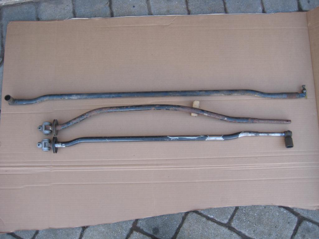

rgalla9146
post Nov 10 2016, 09:14 AM
Posts: 4,954
Joined: 23-November 05
From: Paramus NJ
Member No.: 5,176
This is what I did.
It's an assembly of four pieces.
I used the front and rear of a side shift rod with
a length of rear shift grafted into the middle. Done in a fabed' jig.
This is for a 6 conversion with stock heat exchangers.
I used the curved sections of the rear shift rod to create an offset to clear the HEs.
I'll do the same for the 915 installation which has a 916 replica side shift mechanism.
