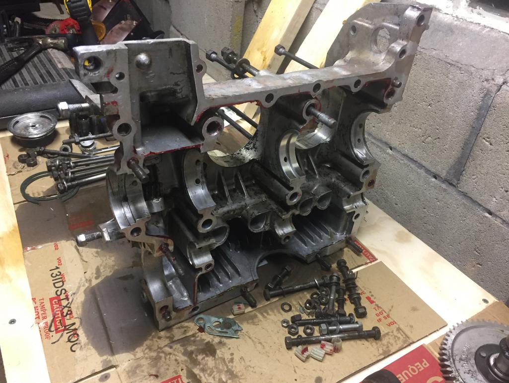

Probably not much effort for those that have done it before but I'm getting an education as I go and thinking each step through so that I don't do damage. It sounds like that dowel hole will need to be welded and re-drilled and should never have been left. The sump tray seal also looked like it was installed incorrectly and partially crushed. Probably a good thing was never finished and cranked.
Any other suggestions while I have it in the Bridgeport? I'm thinking about having the blind holes capped with threaded inserts.
A few more images of the disassembly.

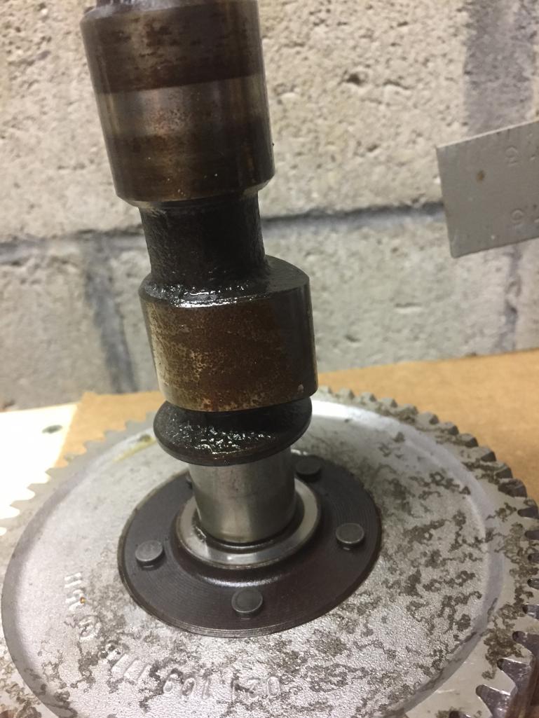

Pitted cam lobe as a result of the ending being left open. It's funny because the finished side was all plugged with rags and the other side was wide open like this project came to an abrupt halt. All new seals, all new bearings. What a waste of time and resources.
