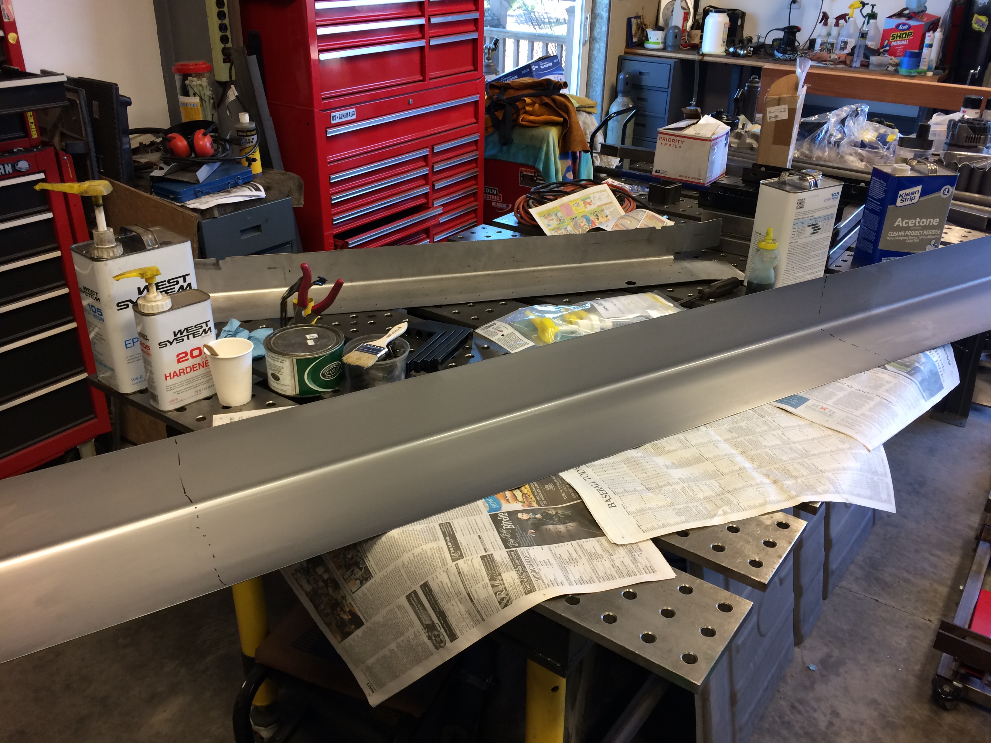

I'll just have to do something "light weight". Fine. I'll make some carbon fiber trim panels! I've always liked the Singer treatment where they cover and paint the longs and tunnel in body color so I've decided to do that, too.
The simplest thing to do was to use one of the stiffening blanks as the mold.

tygaboy   So... the good/bad news is that this week I had my...   Nov 12 2016, 05:26 PM
tygaboy   I have a bit of 50" wide, 2x2 twill weave lef...   Nov 12 2016, 05:29 PM
tygaboy   A little mold release wax and PVA, then 2 layers o...   Nov 12 2016, 05:32 PM
tygaboy   And before you ask, yes, these covers are purely e...   Nov 13 2016, 09:23 AM
