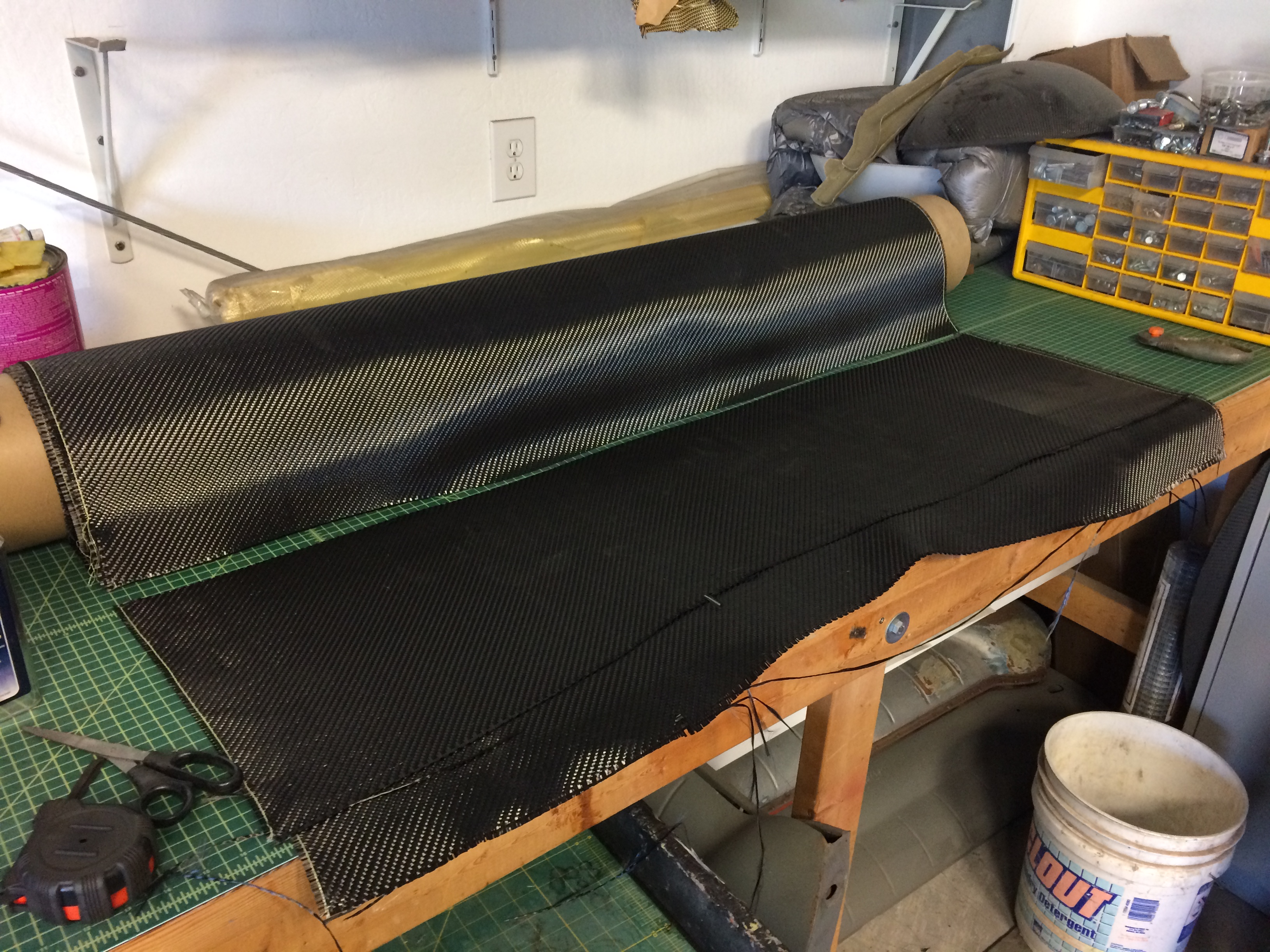

I have a bit of 50" wide, 2x2 twill weave left over from when I was doing all the motorcycle parts. Perfect width to make a long cover!
This is the "composite station". I found a giant self healing mat that you see at fabric stores. You can use razor cutters to slice the material and the mat couldn't care less. Very cool.
