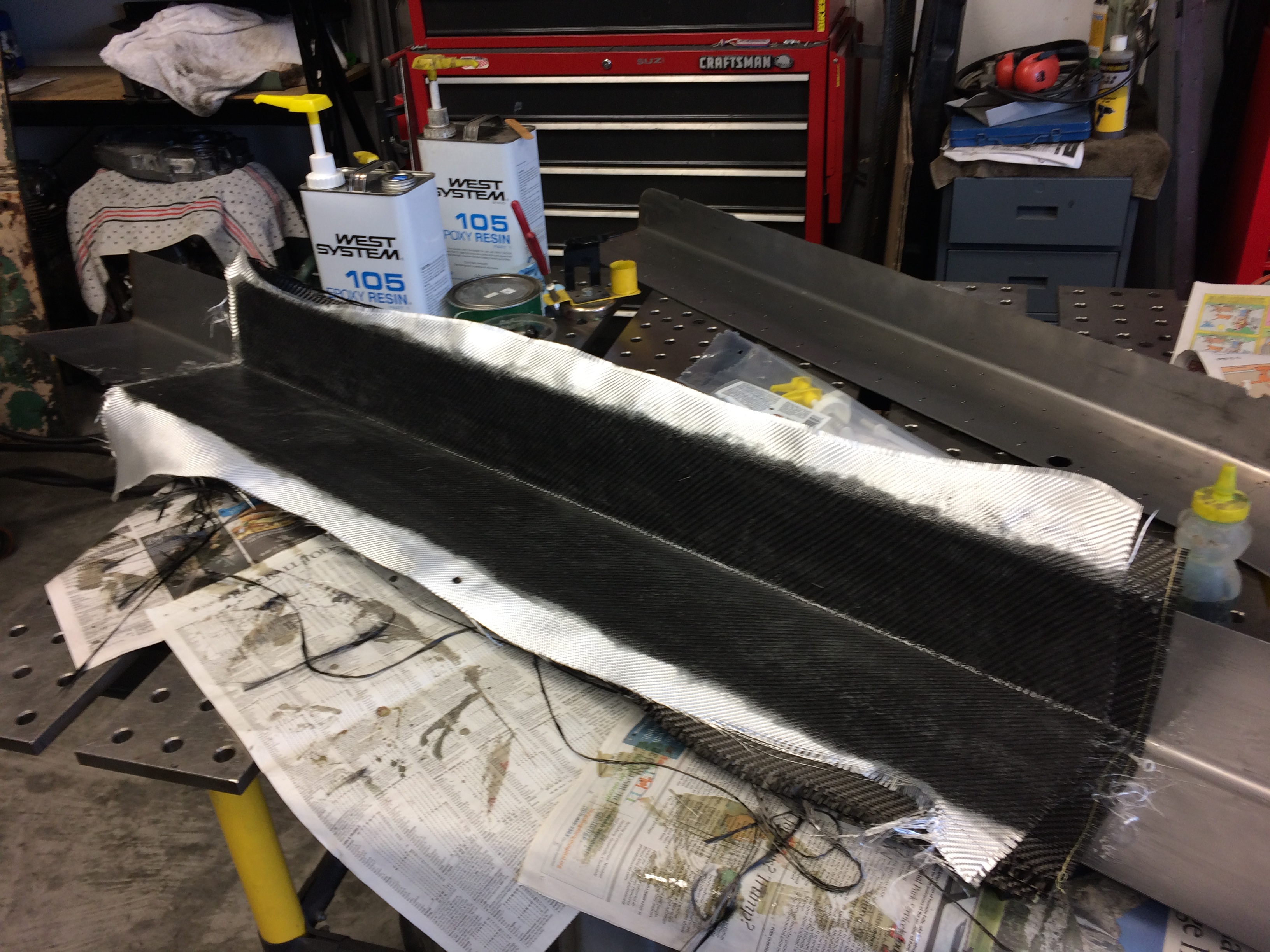

A little mold release wax and PVA, then 2 layers of carbon and one of fiberglass and I'll be set!
This is just a simple wet layup vs vacuum bagging. I have all the vacuum bagging tools but for something like this, that will likely be painted, this is quicker and less costly.
You think it's boring watching paint dry? Try watching epoxy cure! (IMG:style_emoticons/default/laugh.gif)
