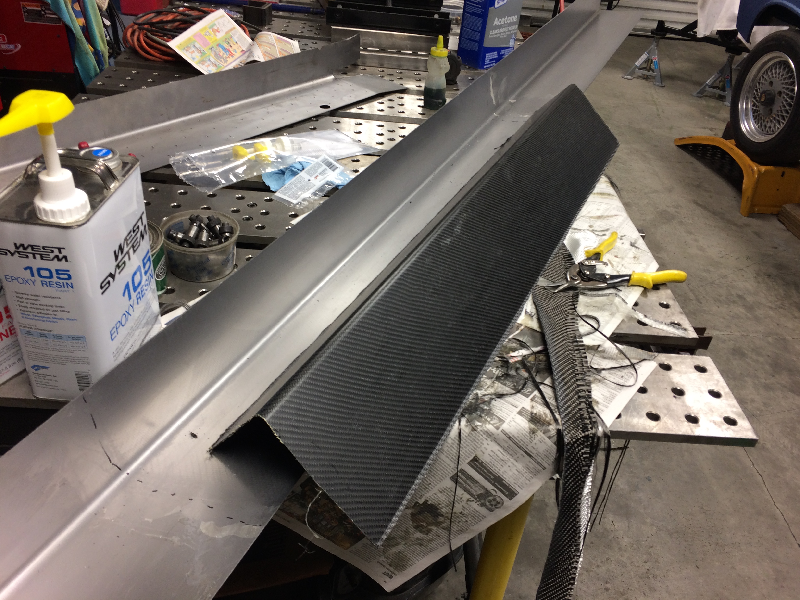

And before you ask, yes, these covers are purely esthetic and therefore, break my Cardinal Rule of Composites:
Using carbon fiber to ADD weight! (IMG:style_emoticons/default/lol-2.gif)
But hey, with 430 hp, what's a few ozs?
So, fresh out of the mold with a bit of trimming, may I present: one carbon fiber 914 longitudinal cover blank!
