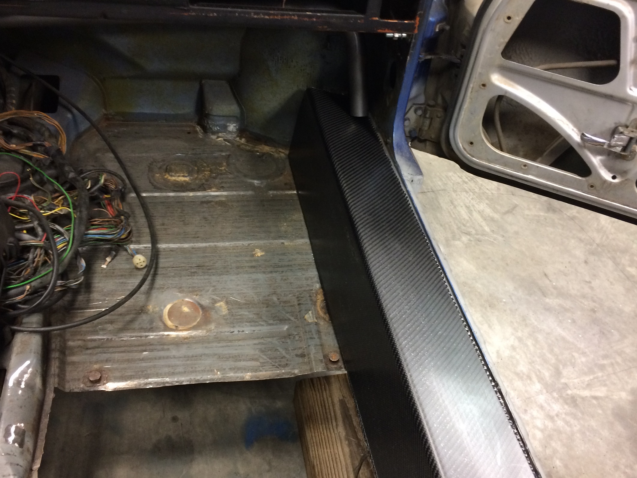

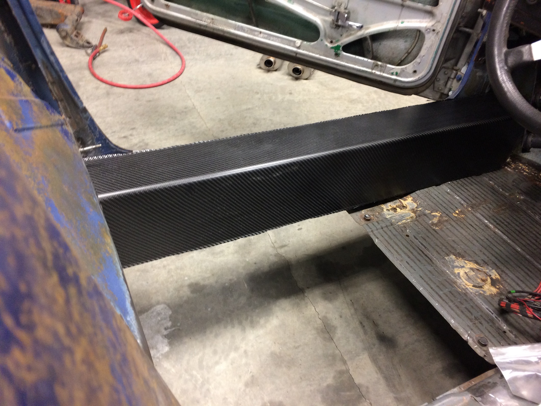

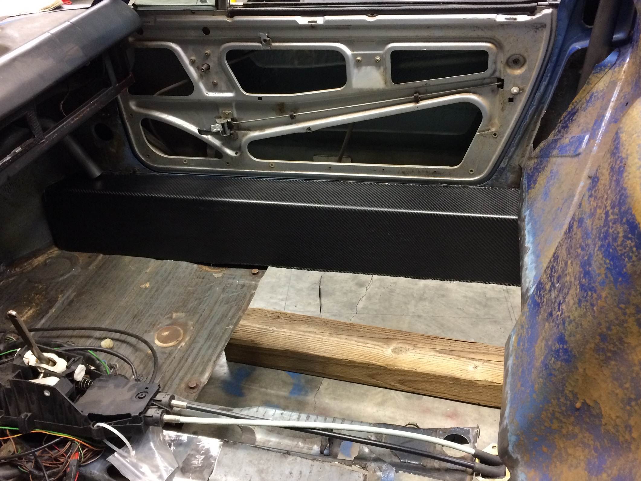

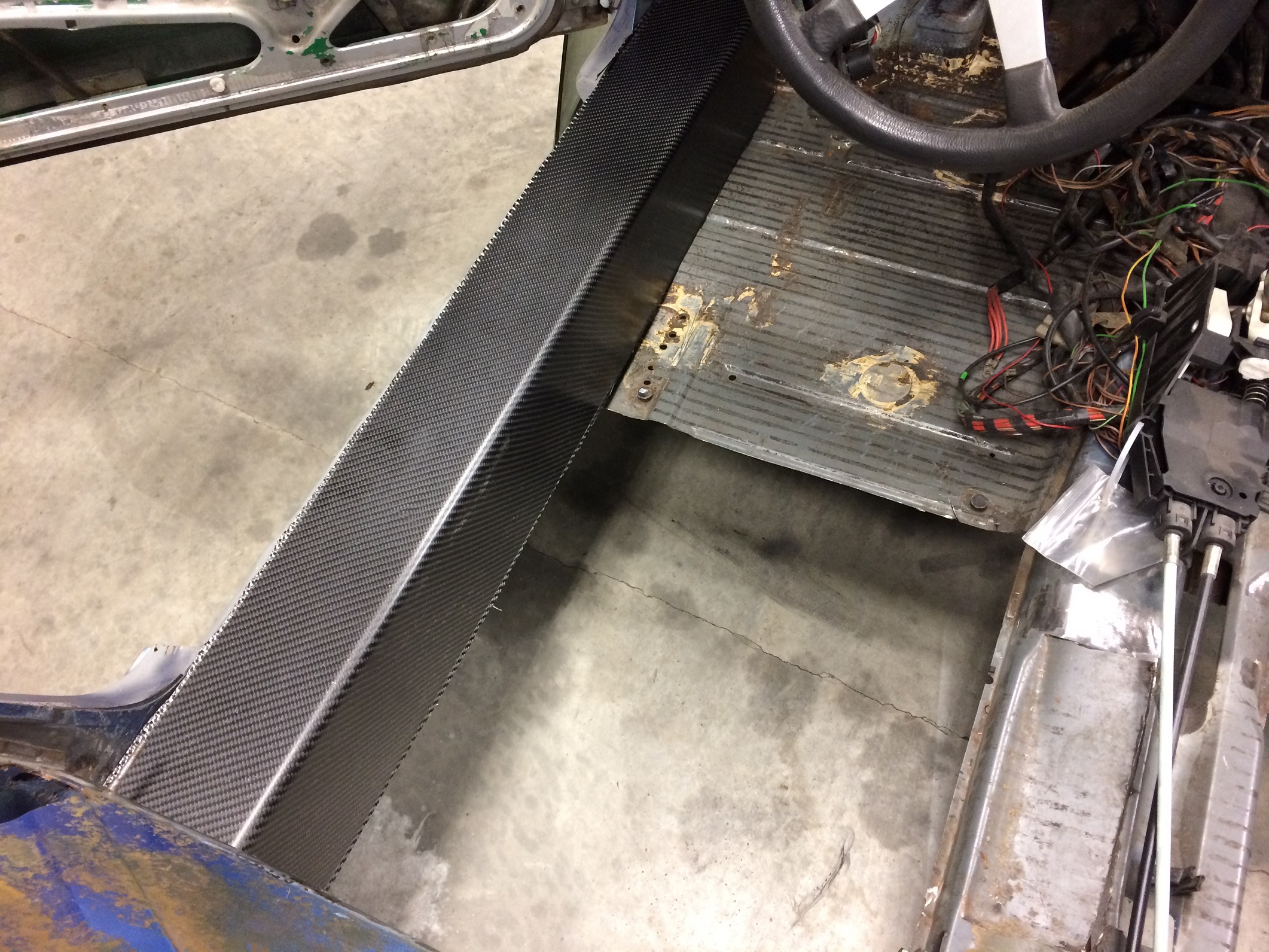

A couple of pics to give you the idea.
I may have to leave them in raw carbon. Remember, it'll have this treatment on the custom tunnel, too. I kinda like it!
I played around and fitted it on both sides, just to get a feel.
Memo to self: REMEMBER to make the other one a mirror image in terms of the direction of the weave... That's why I didn't make one long piece. It's all about the little details.
