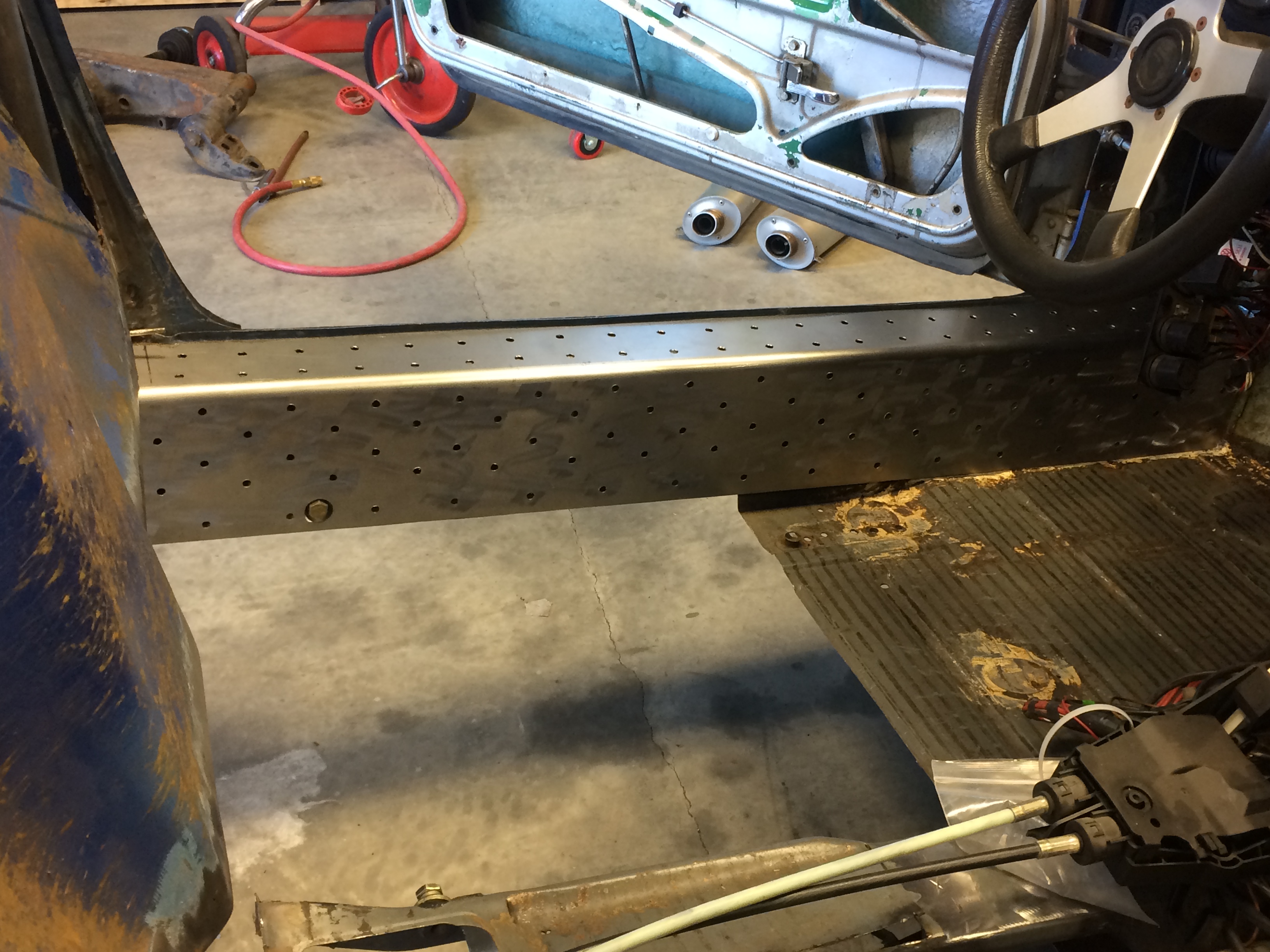

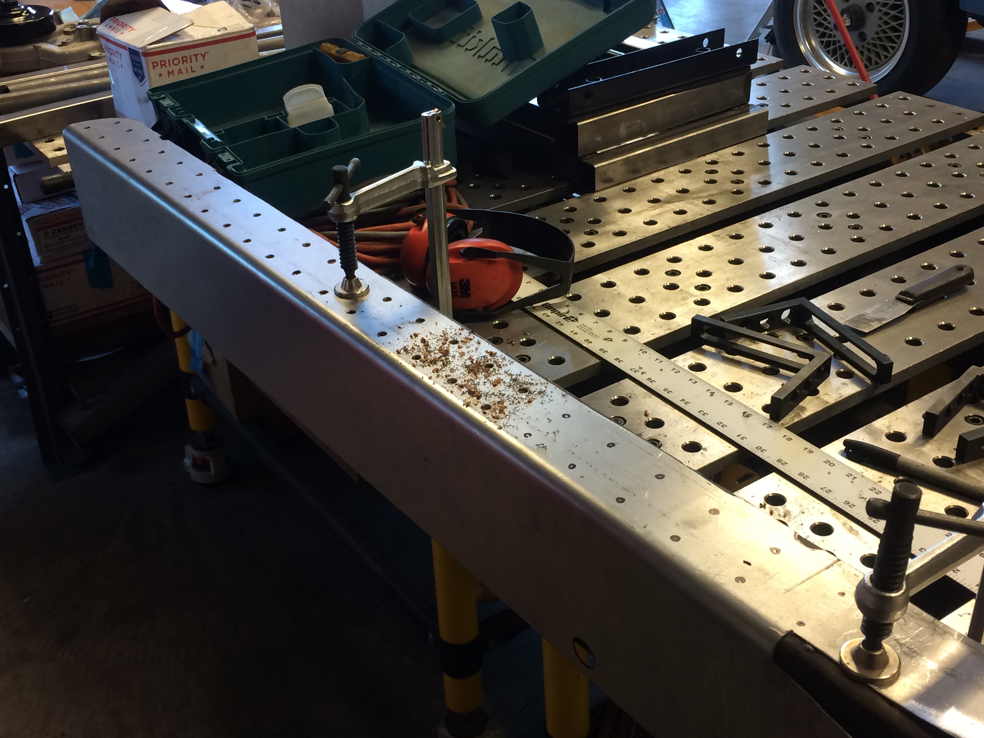

Well this was a "long" weekend! (IMG:style_emoticons/default/lol-2.gif)
Got both carbon long covers done and drilled the stiffeners in prep for installation.
Having installed an Engman kit in another car, I have a new appreciation for parts that come with all the holes in them.

tygaboy   Before I install the long stiffeners, I need to cl...   Nov 18 2016, 06:30 PM
Rand   The ebrake void I get. But, don't bother weldi...   Nov 18 2016, 10:03 PM
tygaboy   The ebrake void I get. But, don't bother weld...   Nov 18 2016, 10:58 PM
Rand   The ebrake void I get. But, don't bother wel...   Nov 19 2016, 12:34 AM
tygaboy   Well, if Rand is concerned I'm overdoing it re...   Nov 19 2016, 01:59 PM
