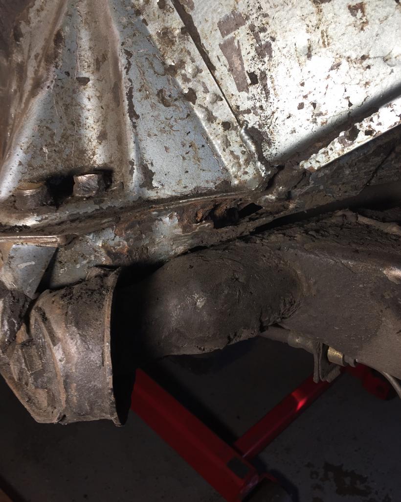

So with the rear panel off was better able to access the work at hand.
Cleaned up a lot of undercoating.
Found a decent sized hole on the left susp. console.
So I'll be ordering a bit more steel. I want to next remove
the lower inner firewall , to clean up and cut out around and including
the seatbelt anchor.

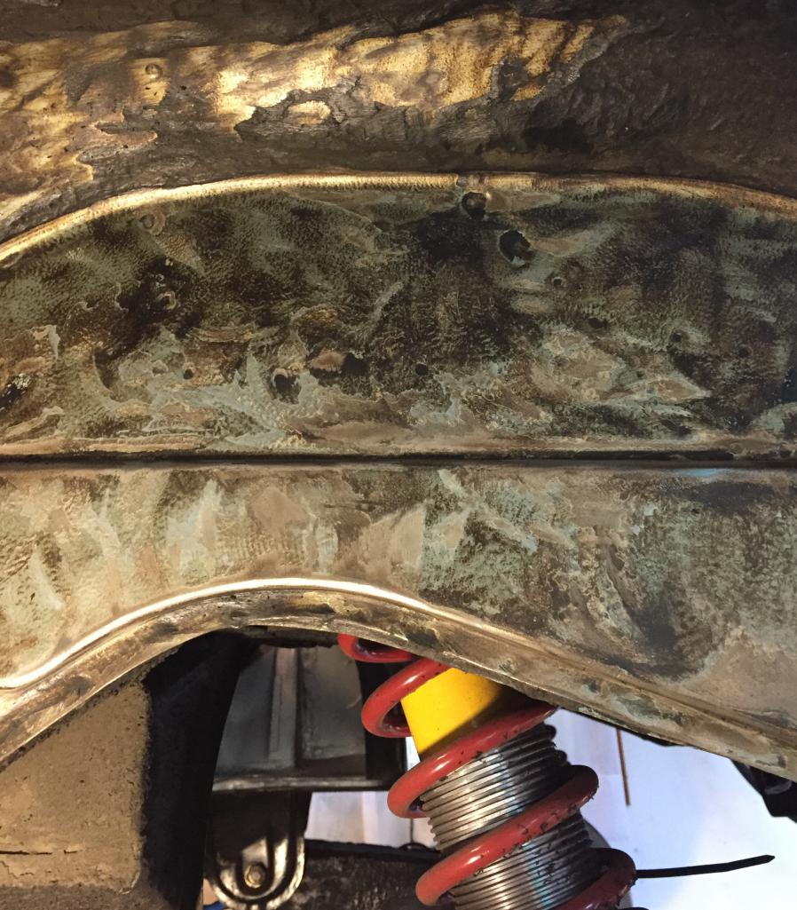

Dion   So with the rear panel off was better able to acce...   Nov 13 2016, 04:13 PM
Dion   Deterioration   Nov 13 2016, 04:14 PM
