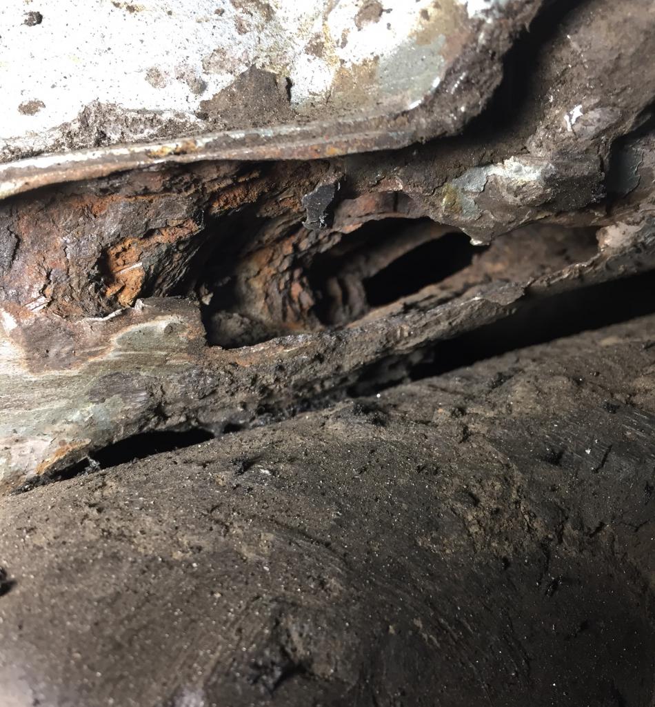

Dion   So with the rear panel off was better able to acce...   Nov 13 2016, 04:13 PM
Dion   Deterioration   Nov 13 2016, 04:14 PM
tygaboy   Dion - I have a '72 donor car that is virtuall...   Nov 13 2016, 07:43 PM
