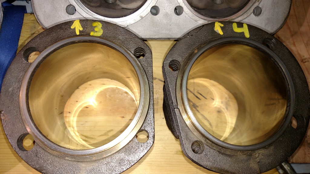

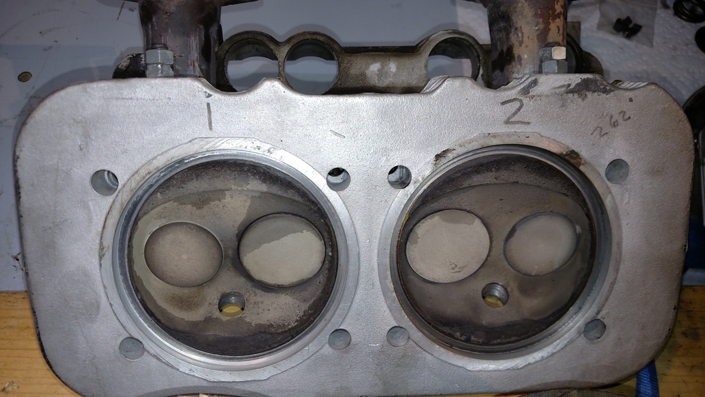

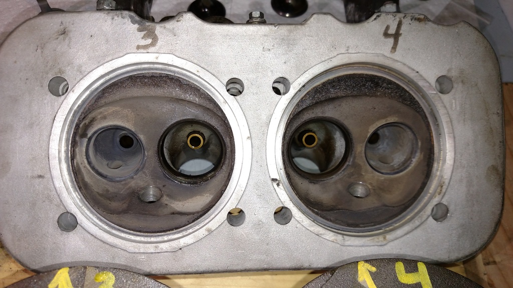

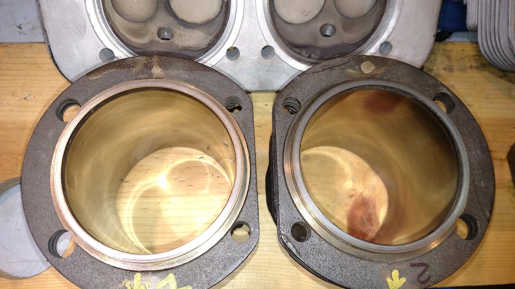

Ok, I stayed out of this conversation towards the end because I had just finished my last race of the year.
During that race I was hearing a loud "Brrrrrrrrrppppppp!!!" whenever I exceeded 6200 RPM.
I thought it was an exhaust leak, found one leak, fixed it, and the noise did not go away.
I was worried it was a head leak.
SO I decided to pull the motor at the end of the season and have a look.
First compression test just before pulling the motor was bad - 60-70 PSI cold, 75-80 PSI warm - Not good results.
So I pulled the engine Saturday and got the heads off yesterday.
This engine is a 9.5:1 CR and I routinely rev it above 6200 RPM during hard racing (20 minutes at a time).
During disassembly I DID find at least one exhaust leak between the stubs and the headers, so that was probably my "Brrrrp!!" noise.
I assembled this engine with no head gaskets jugs were brand new and heads had just been machined down to decrease comb chamber volume.
I did NOT hone these heads or do anything other than bolt them up.
When I took the engine apart I checked the torque on all the bolts and some were a little low (~20 ft-lbs).
I can detect ZERO leakage or blowby on the sealing surfaces.
My valves are a different story.
(IMG:http://www.914world.com/bbs2/uploads_offsite/i366.photobucket.com-10819-1479145075.1.jpg)
(IMG:http://www.914world.com/bbs2/uploads_offsite/i366.photobucket.com-10819-1479145075.2.jpg)
(IMG:http://www.914world.com/bbs2/uploads_offsite/i366.photobucket.com-10819-1479145075.3.jpg)
(IMG:http://www.914world.com/bbs2/uploads_offsite/i366.photobucket.com-10819-1479145076.4.jpg)

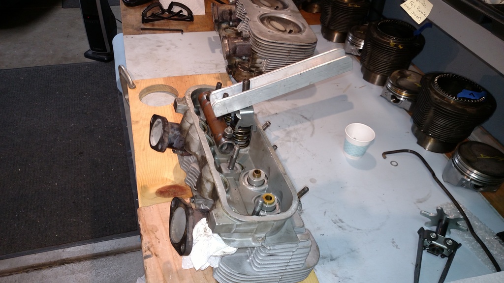

And here is my home made spring compressor
(IMG:http://www.914world.com/bbs2/uploads_offsite/i366.photobucket.com-10819-1479145076.5.jpg)
SO long story short: No head gaskets, no special prep (other than GOOD mating surfaces), normal torques, 9.5:1 CR and engine routinely reved above 6200 RPM.
No discernible leaks after 2 race seasons.
The engine looked like new inside.
So run head gaskets if you want, I dont, and I am fairly certain that I beat on this engine more than your average DD.
