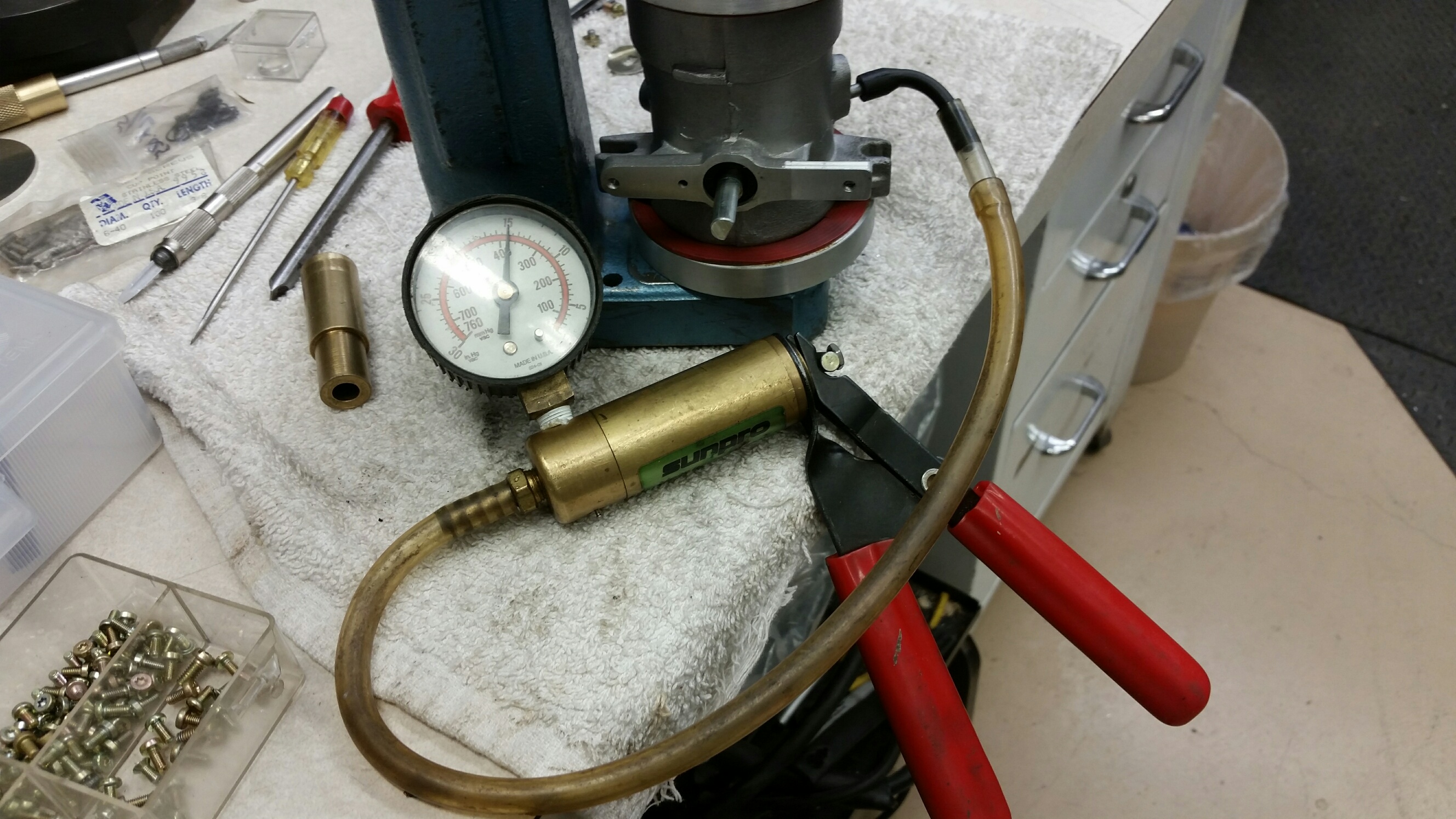

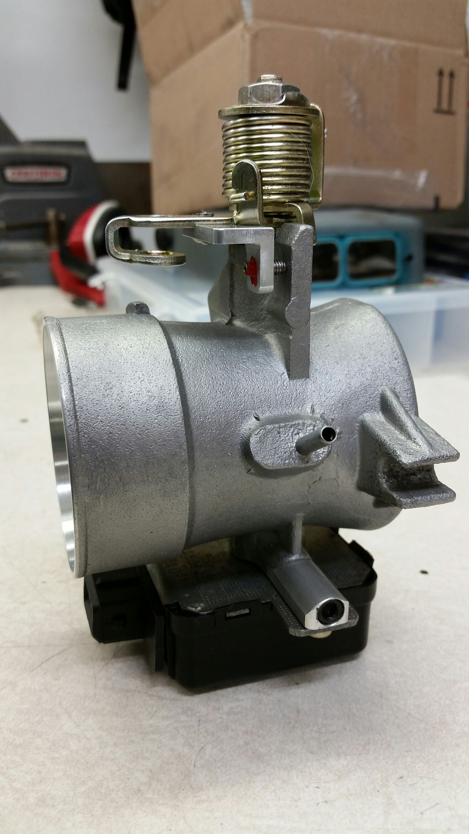

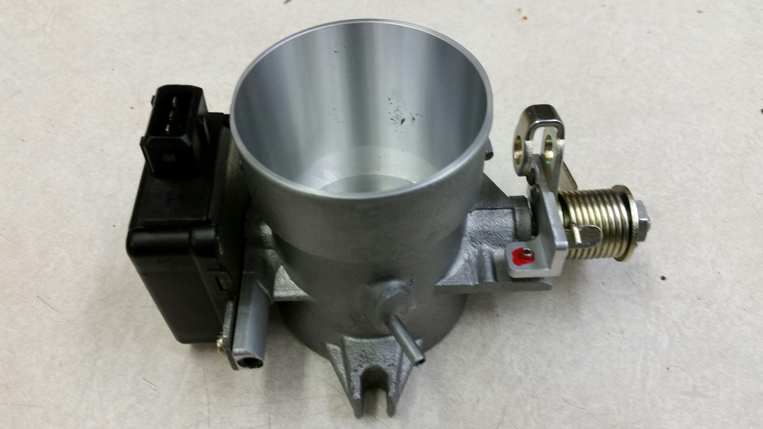

Just installed the modified vanagon TB; sent the TB and a TPS to Zphil in New Mexico. He did a total rebuild and it looks like new. The difference in noticeable; we just did a top end rebuild with 96mm P & Cs.
A few pics sent by Phil during rebuild.
