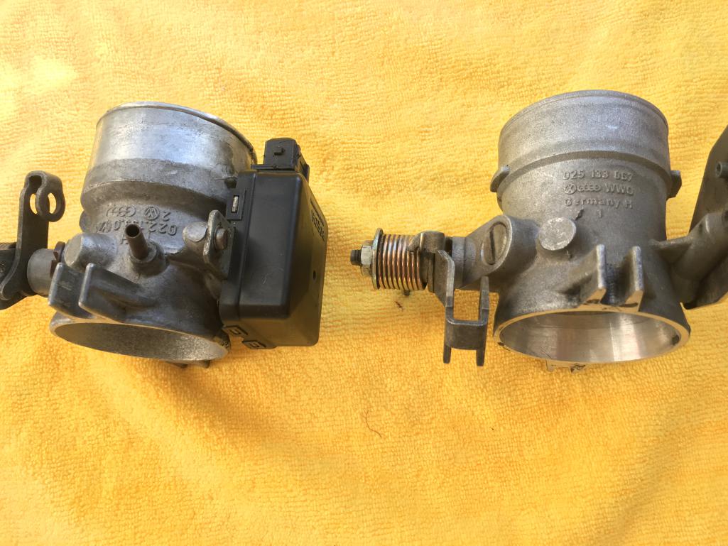

There's currently a thread about using L-jet from a 1.8L engine for a 2.0 with discussion about using bigger bore throttle body from a later Vanagon.
I tried it but ran into an issue with the orientation of the flat on the shaft that engages the throttle body switch component used with L-Jet.
Pictures are worth a thousand words, so here goes..
Here's the TPS and a picture of each TB with the plate in the throttle closed position. Original 1.8 L-jet on the right, Vanagon donor TB on the left. Notice the different orientation of the flat on the shafts. The flat engages a corresponding flat on the TPS. The flat on the Vanagon shaft is in the wrong position for the TPS.

Pic of the orig 914 TB next to the Vanagon before modifying
