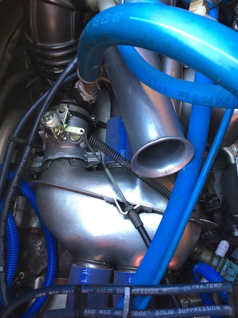

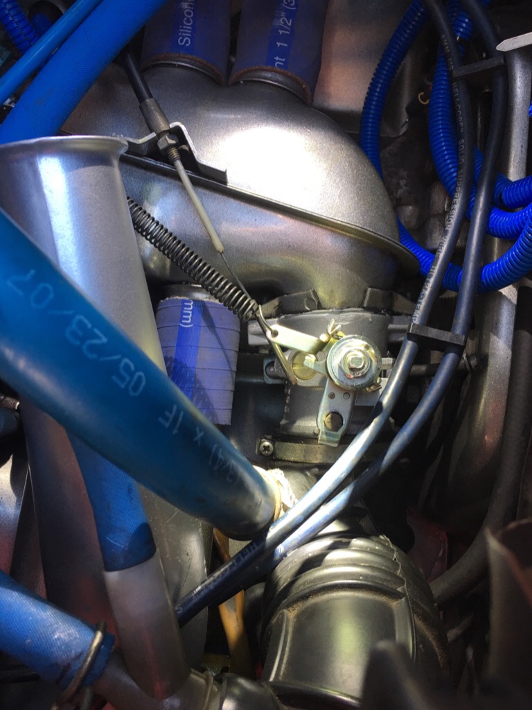

Jim, what did you find to feel different? How was the idle?
Looks like very nice work. (IMG:style_emoticons/default/beerchug.gif)
jim_hoyland
post Nov 17 2016, 01:02 PM
Get that VIN ?
Posts: 10,152
Joined: 1-May 03
From: Sunset Beach, CA
Member No.: 643
QUOTE(Porschef @ Nov 17 2016, 09:59 AM) *
More power! Complements the larger P & C
Idle is fine
One problem this am: the angle of the TB accelerator arm is another 10 degrees back making it had to acetate smoothly. Going to contact Mr Kona
