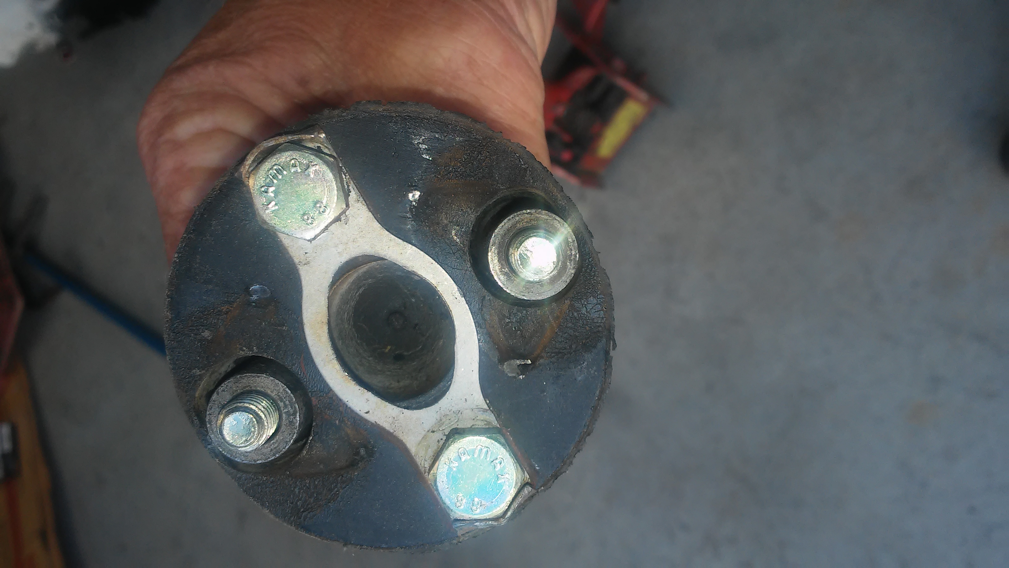

is this coupler shagged?Attached Image

I don't know (I can't tell exactly from that picture) but something is...

stownsen914   I would think that if the steering coupler were th...   Nov 20 2016, 09:50 AM
Cracker   Trust me on this...I had thought I had a mechanica...   Nov 20 2016, 10:26 AM
returf   Trust me on this...I had thought I had a mechanic...   Nov 20 2016, 12:56 PM
Randal   Trust me on this...I had thought I had a mechanic...   Dec 16 2016, 11:41 AM
John Jentz   is this coupler shagged? Don't know if that...   Nov 20 2016, 03:26 PM
Cracker   Yes. Mainly only under braking - massive vibration...   Nov 20 2016, 01:08 PM
stownsen914   Yes. Mainly only under braking - massive vibratio...   Nov 25 2016, 08:30 AM
jmill   is this coupler shagged? Yes, that's garbag...   Dec 5 2016, 07:00 PM
returf   Thanks for all your advice Guys. I'm working t...   Dec 18 2016, 01:34 PM

returf   Just a bit of an update on the vibration issue. I ...   May 15 2017, 03:21 AM
Cracker   Bravo! FWIW: I have 5mm of total toe-in on the...   May 15 2017, 06:20 AM
returf   Sorry Tony, I meant to say 2mm toe in each side. Y...   May 16 2017, 04:46 AM
