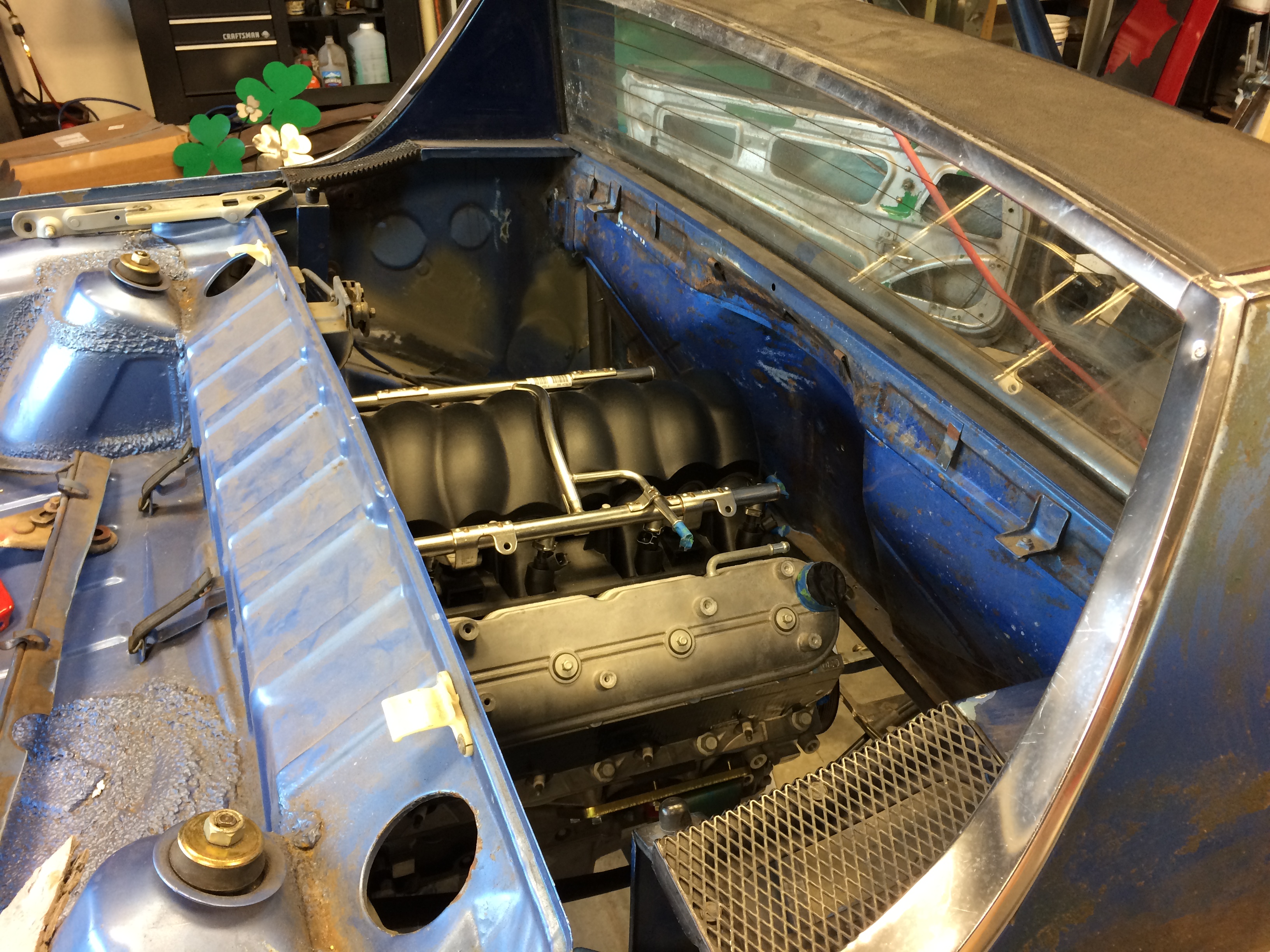

Major milestone! Got the engine and trans mocked in! (IMG:style_emoticons/default/piratenanner.gif)
The throttle body isn't installed (clearly) so now it's time to formalize plans for mods to the trunk to get the needed clearance. I've got a couple different ideas and I need to choose one pretty soon.
But for now, I can finish the lower firewall and get the floor installed knowing I have all the space needed.
I've been feeling a bit stuck but after today, it's full speed ahead. A good feeling.
