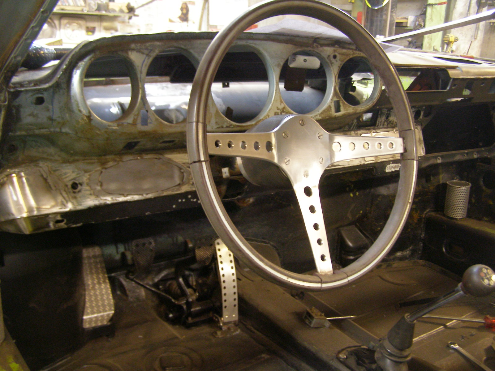

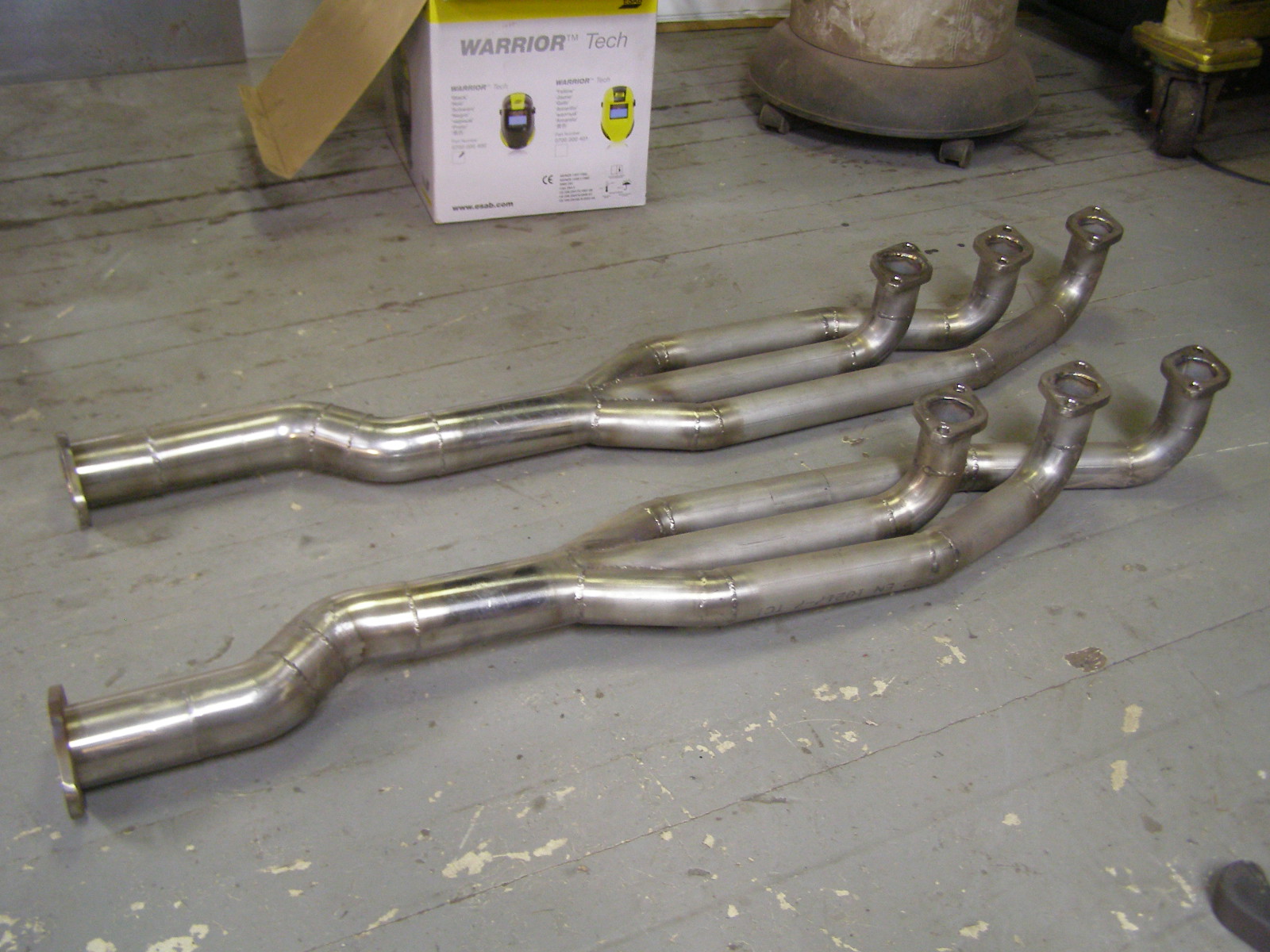

Rewelded the engine mount so it cleared the shifting mechanism that I also had to reweld to clear the homemade headers.....thats the way it is with backyard engineering.
Made a new ,old style?,steering wheel from a 4 mm stainless plate.I'm not sure if I like it yet.Dressing it up in leather later and adding a small Porsche decal i center.
