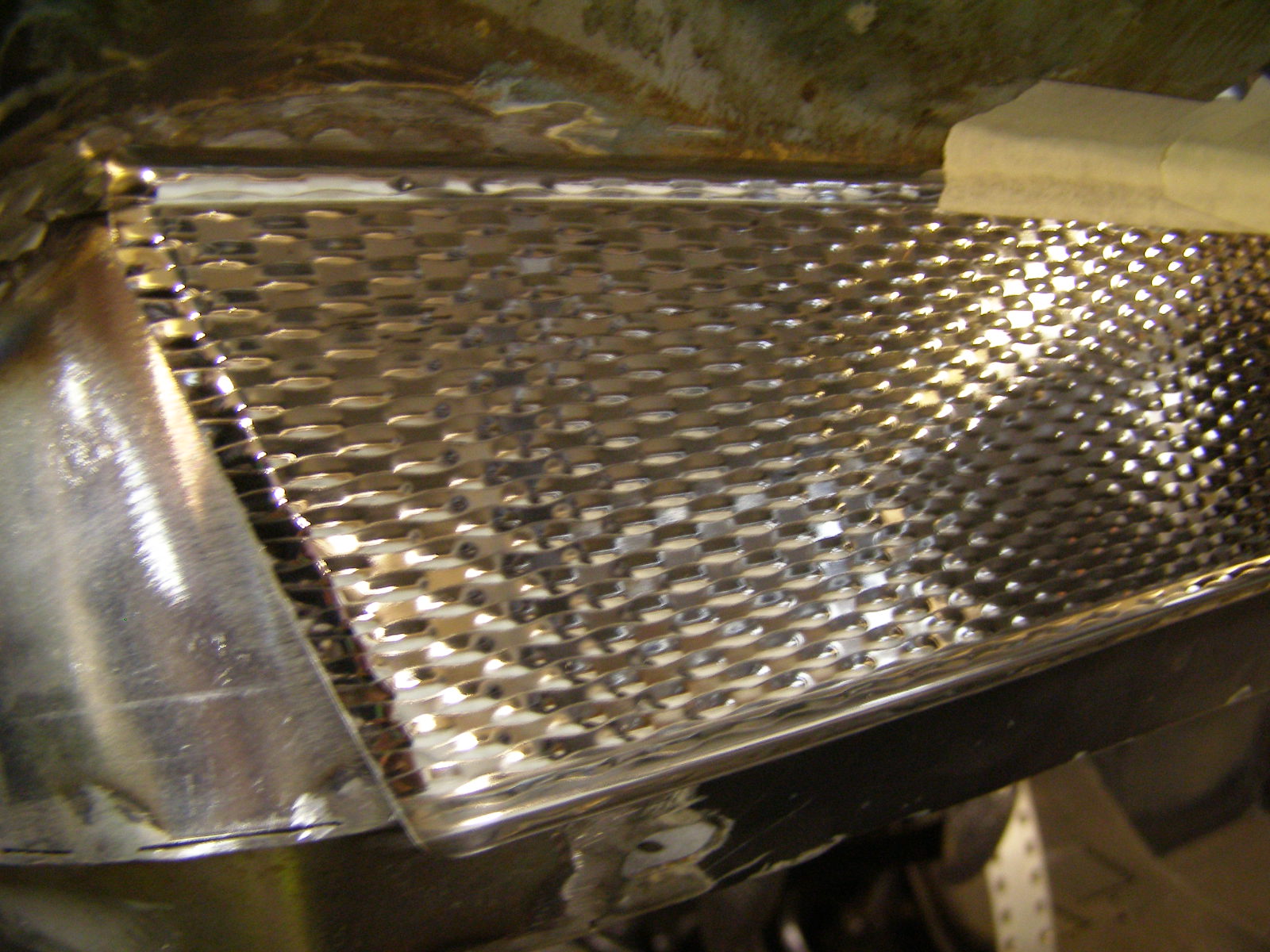

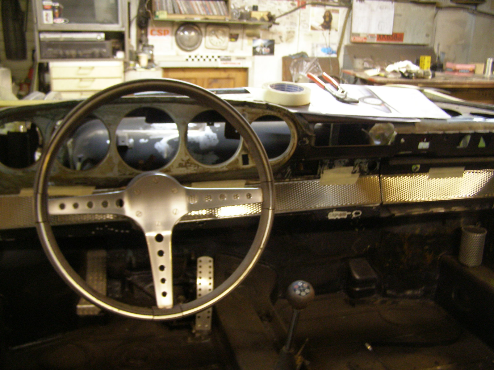

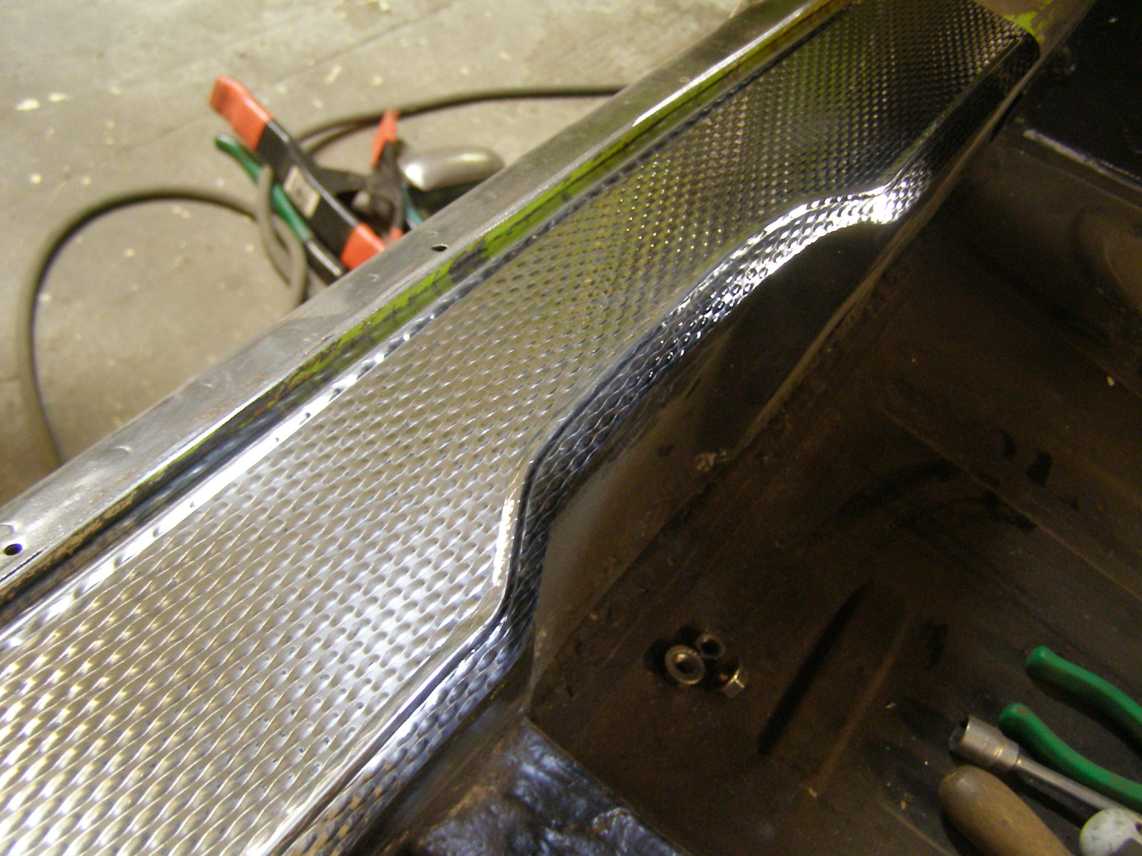

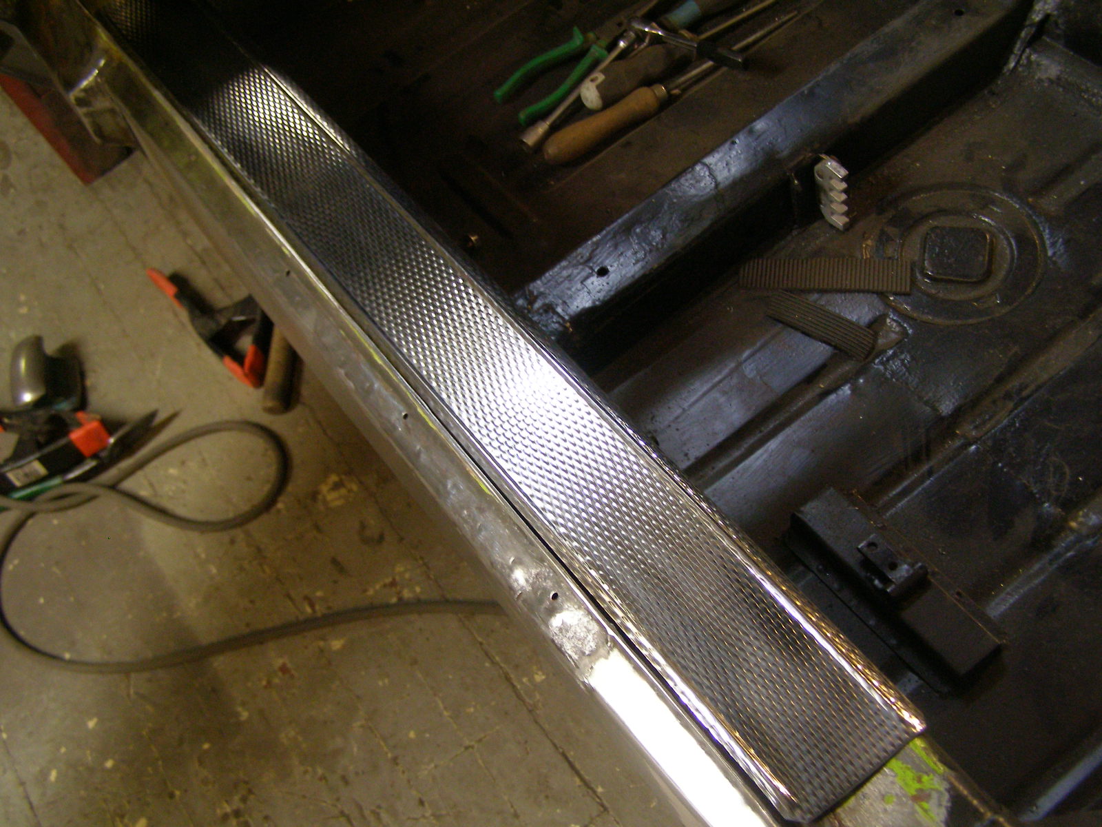

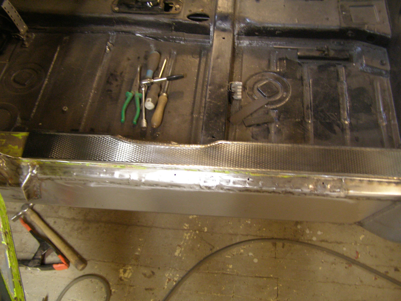

Sad to say but the dashboard was cut out,so I'm using the 911 dash.Moved the glovebox lid hinge in one inch as I don't have a kneepad and keeping the dash clean.Made some panels...maybe too bright and covers to the rockers in the same material....SS 316.
Rear brakeshields was rusted away...new ones in alu.
The 914 dash would have suited the car much better.
Reshaping the instrument bowl later so it will contain 3 instruments only.
