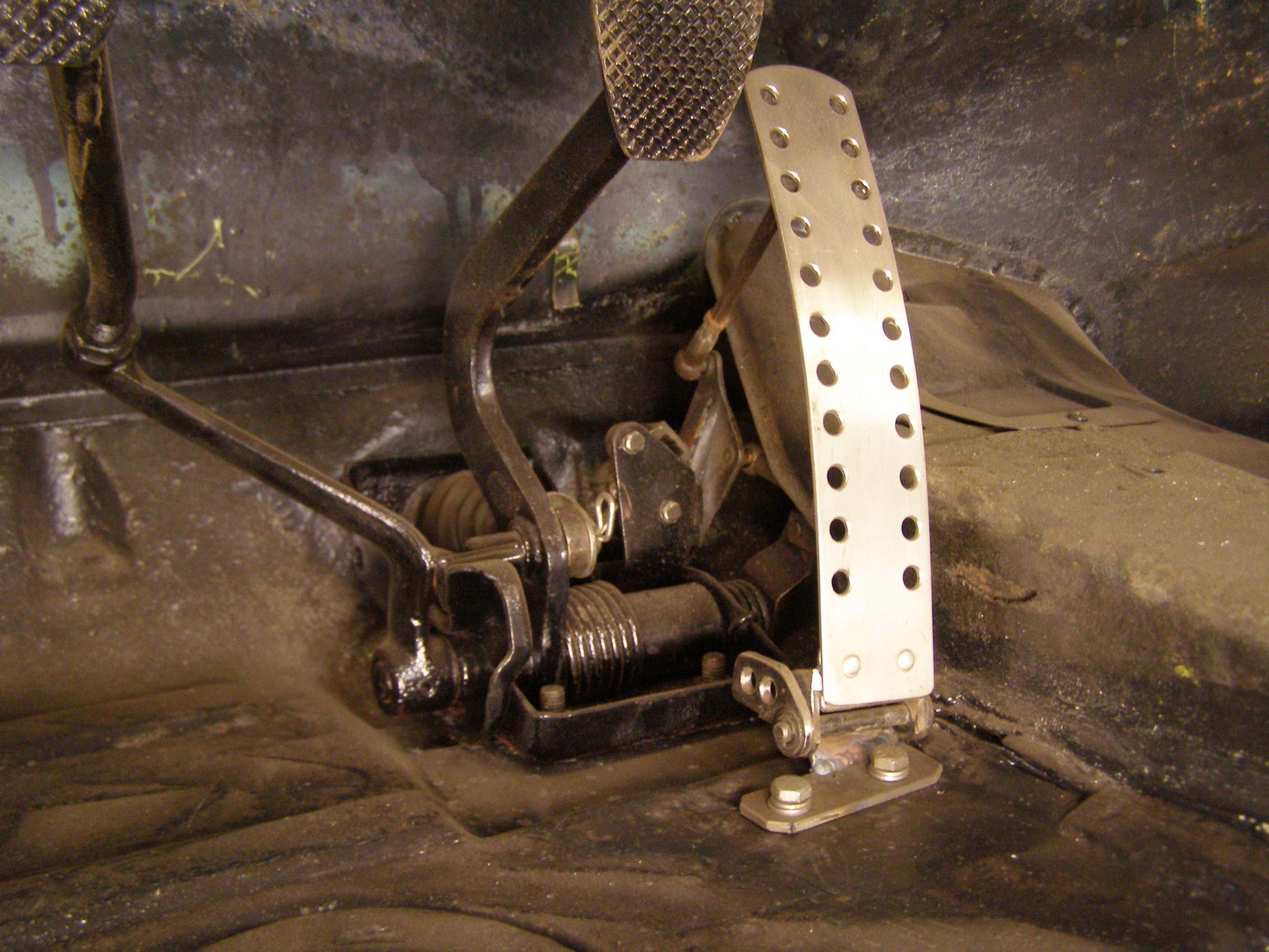

That gas pedal is made from 2 mm ss,glued a piece from the remains of the original pedal in the back so I could use the accelerator rod.Make a copy,Chris.
Working with the doors now.Moved the A-pillars in 25 mm and the upper hinges down 50 mm.Don't know how it will turn out....
