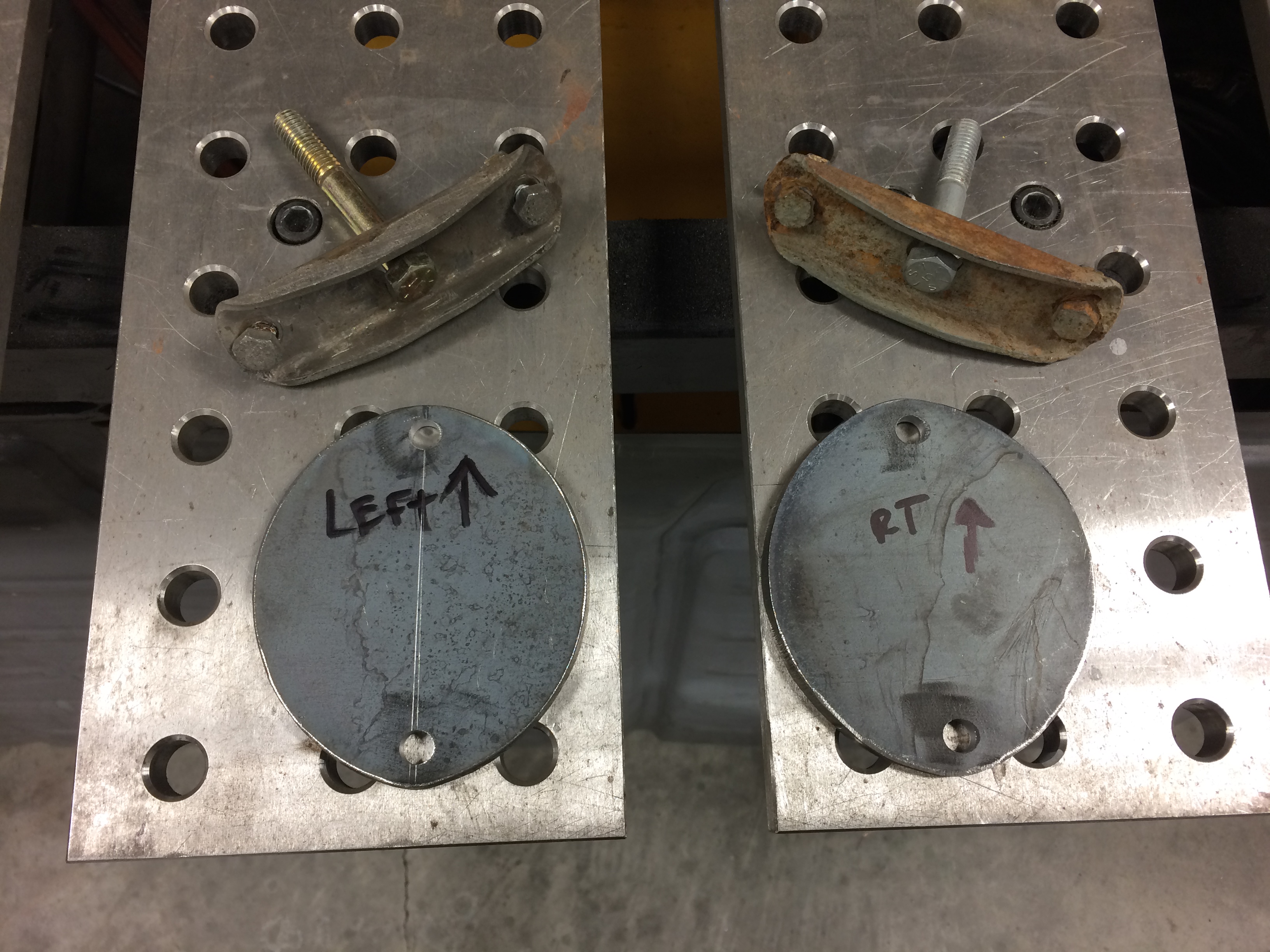

Some of this fab work isn't the most exciting but it needs doing. Tony (Cracker) has suggested moving the engine as far forward as possible to improve the CV angles. The stock engine mounts allow for a bit of movement but not as much as is actually possible. All I need is a set of custom mounts.
Plasma table to the rescue again! 1/4" plate cut to shape. Next I position the drive train where I want it, mount these plates and transfer punch the Renegade engine mount hole location.
The trans mount has some slots that I may be able to lengthen but I suspect there isn't enough material. It's a multi-part mount so if need be, I'll have to make new rear tabs that are 1" or so longer.
It's the sort of mod that will improve reliability so I think it's worth the effort.
