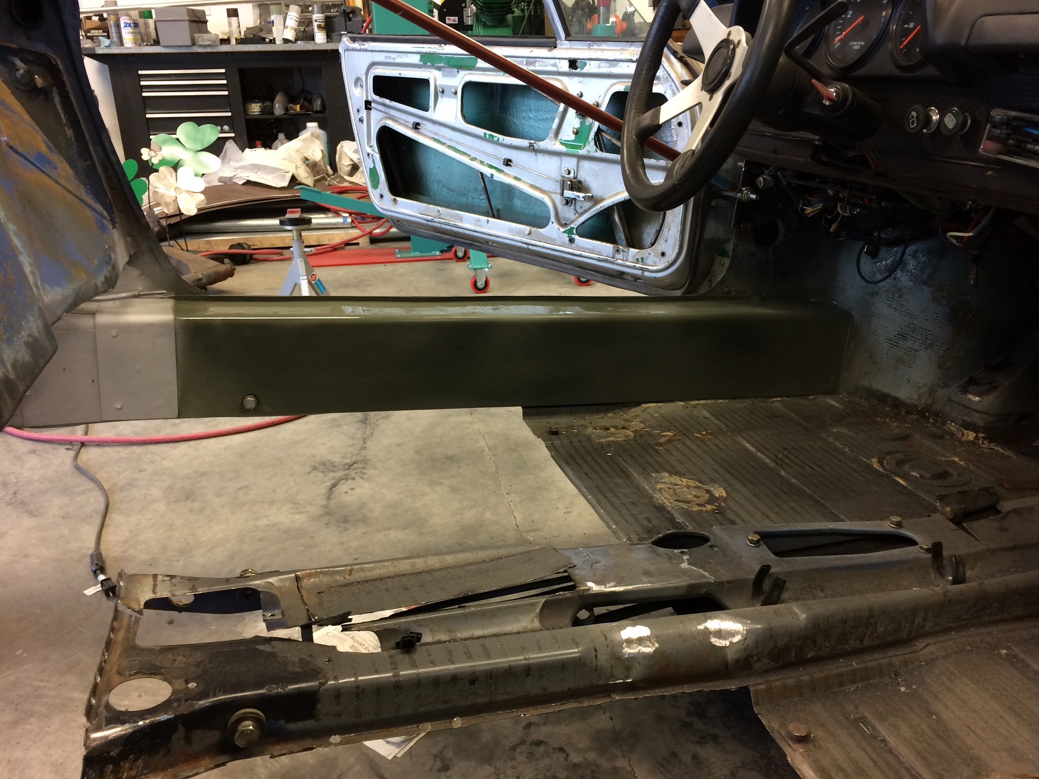

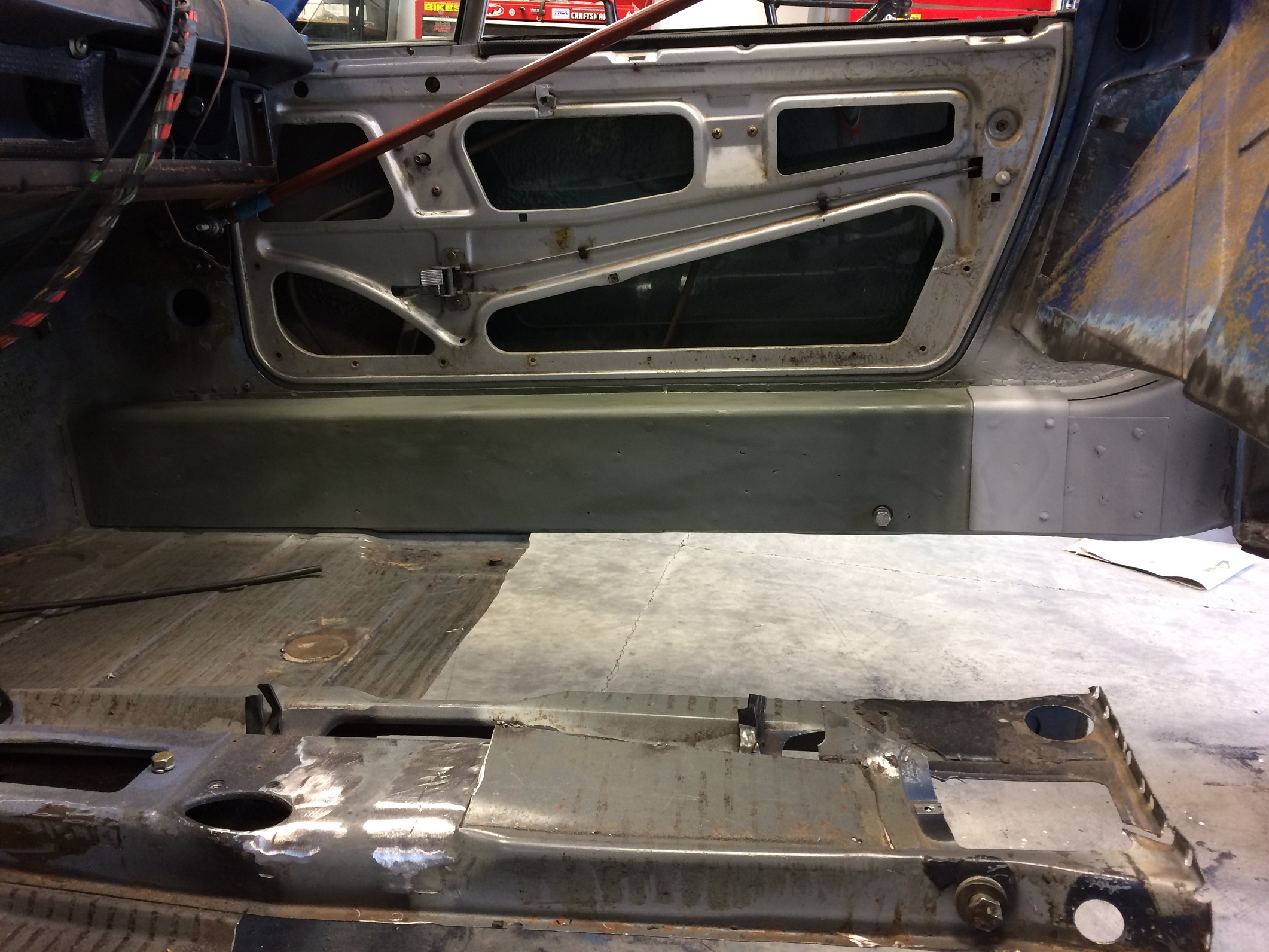

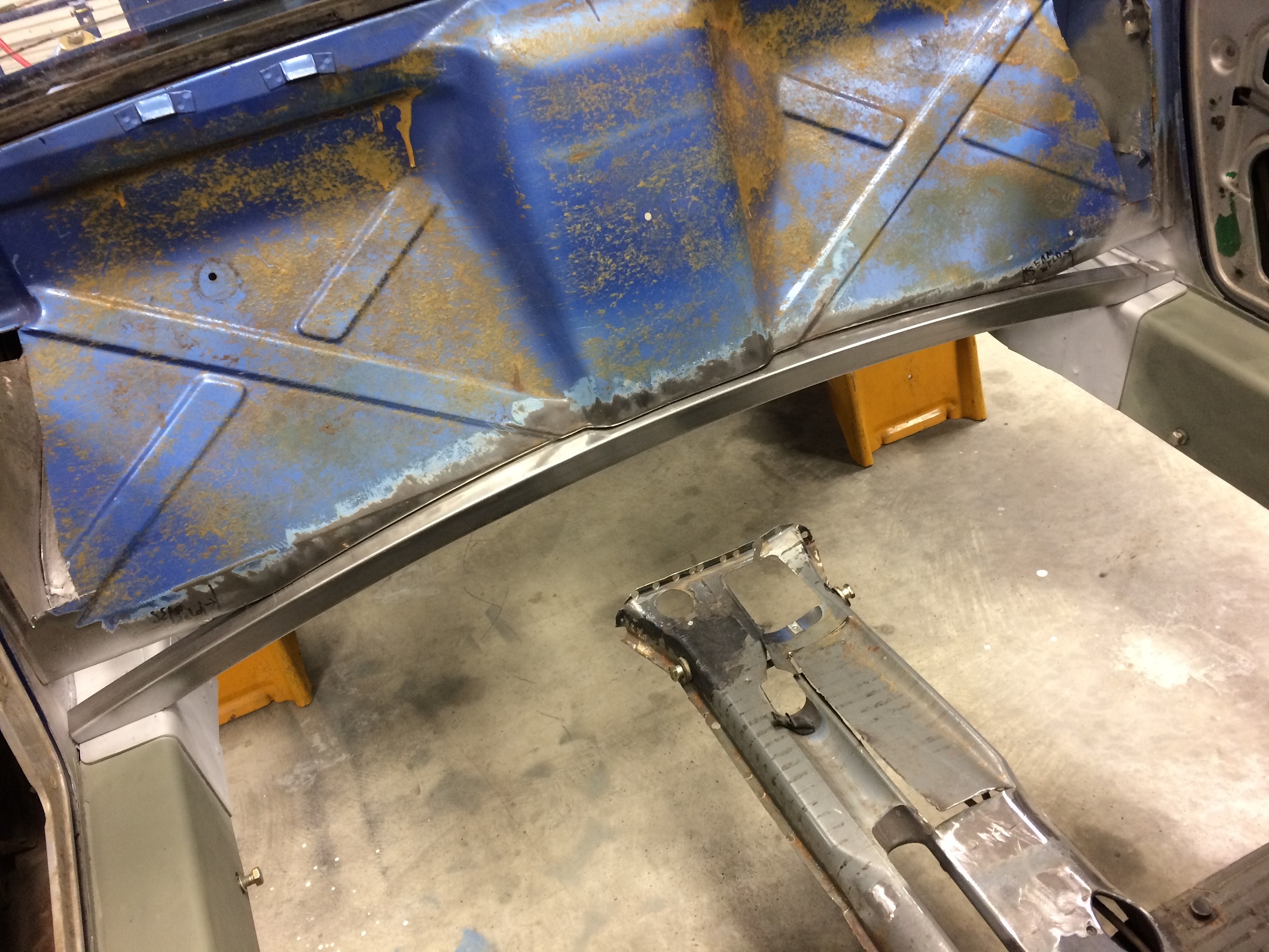

My optimism regarding how much I'd get done this weekend was, well, optimistic.
I was only able to get the stiffeners welded in and the welds ground. Took WAY longer than I expected.
I did get the lower fire wall support pads fit and welded in and the upper brace fit and ready for welding.

tygaboy   In planning the fabrication of the sleeves needed ...   Oct 17 2016, 01:00 PM
tygaboy   I sliced the longitudinal repair section out of my...   Oct 17 2016, 01:11 PM

tygaboy   Hell hole/long repair welding nearly completed...   Oct 17 2016, 02:01 PM
tygaboy   My paranoia paid off and another Tangerine product...   Oct 17 2016, 02:10 PM

tygaboy   CHASSIS STIFFENING: Lower Firewall Today's re...   Oct 30 2016, 09:53 AM
tygaboy   Then it's roll, check, roll, check. Manual rol...   Oct 30 2016, 09:55 AM
tygaboy   Looks good to me!   Oct 30 2016, 09:56 AM
