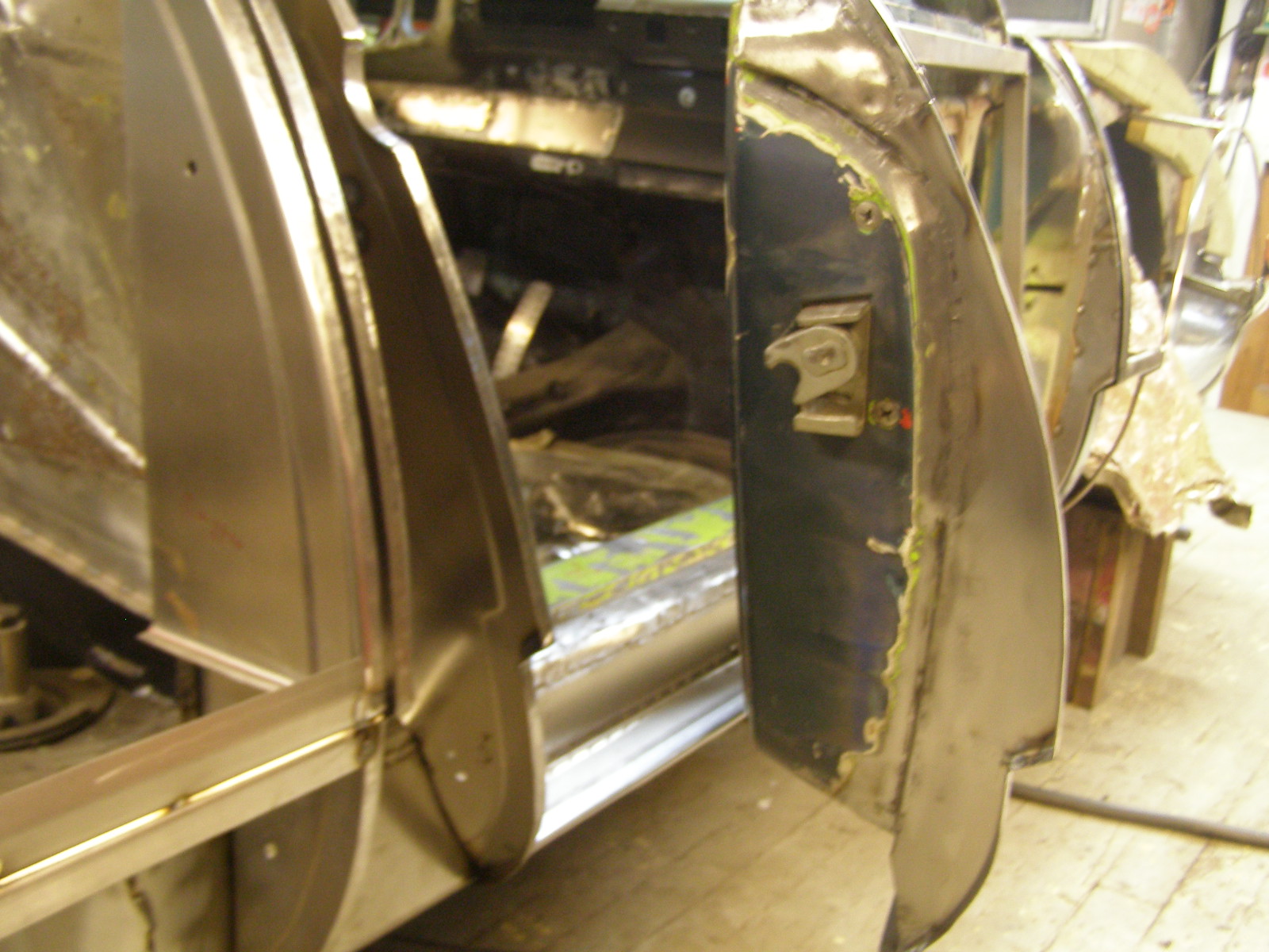

Thanks for the comments,guys and gal.Working on door gaps today.

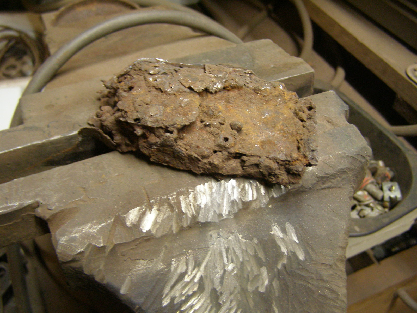

That chunk of metal is the channel beneath the pedals that was filled with steel.

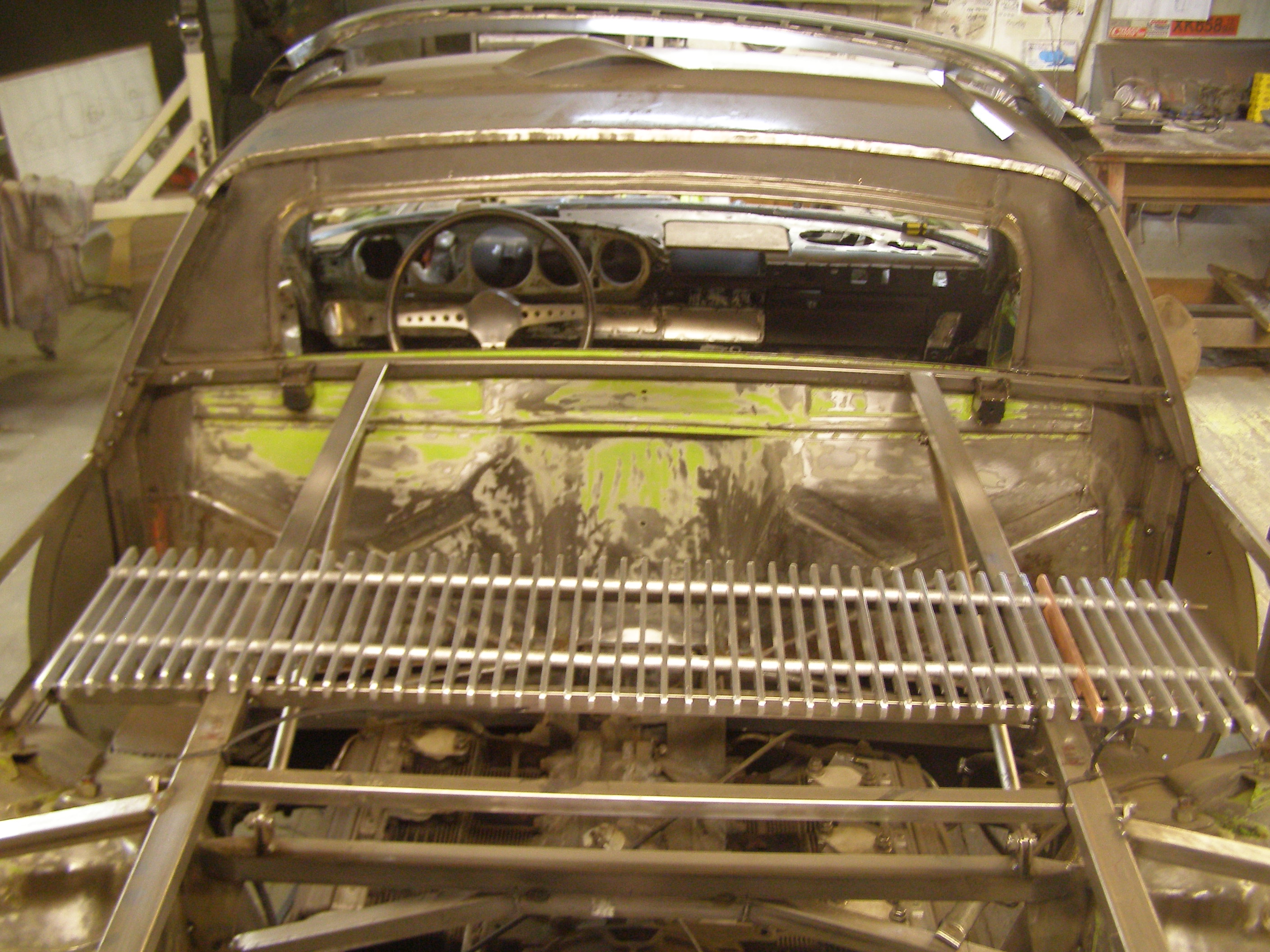

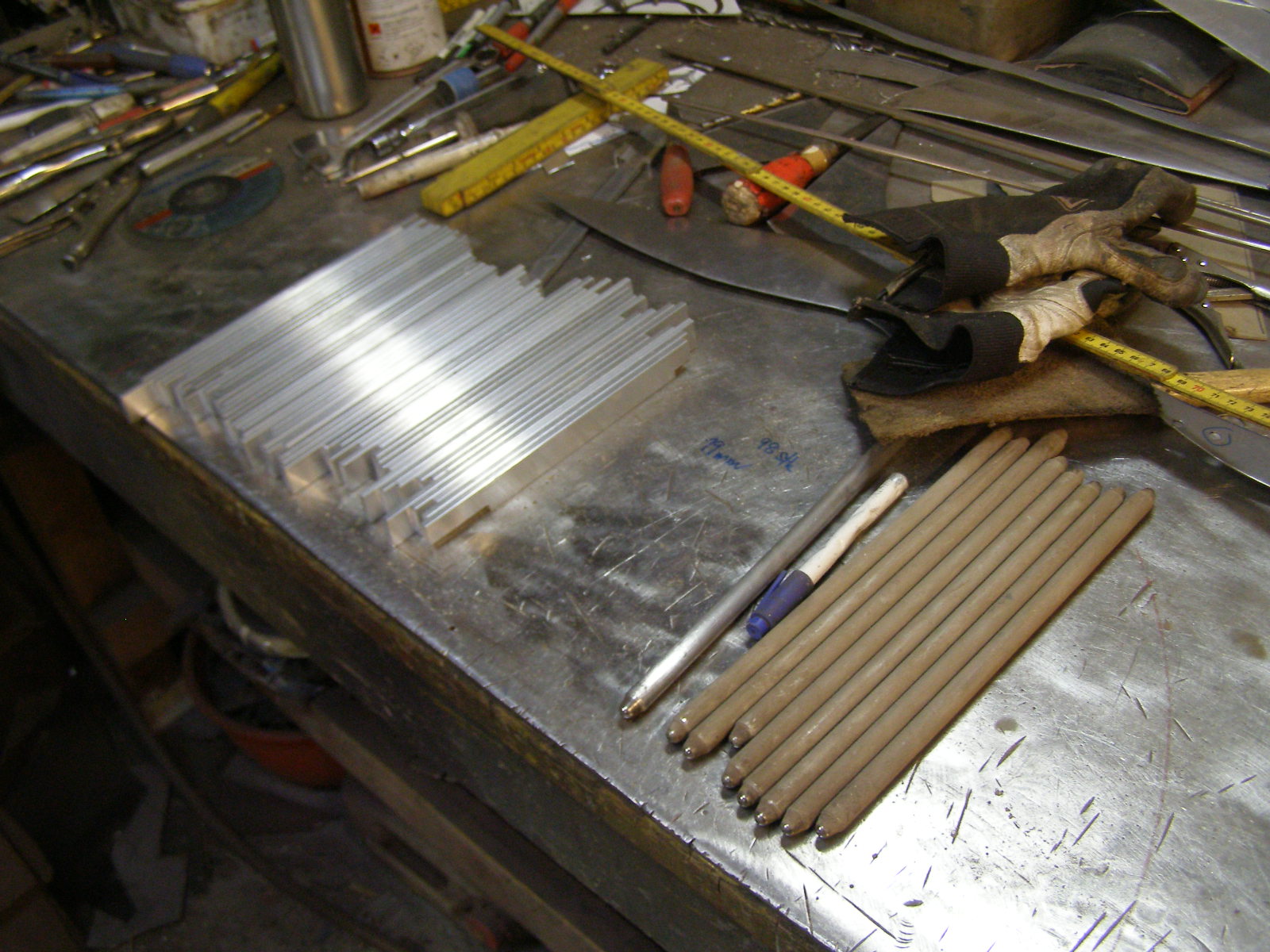

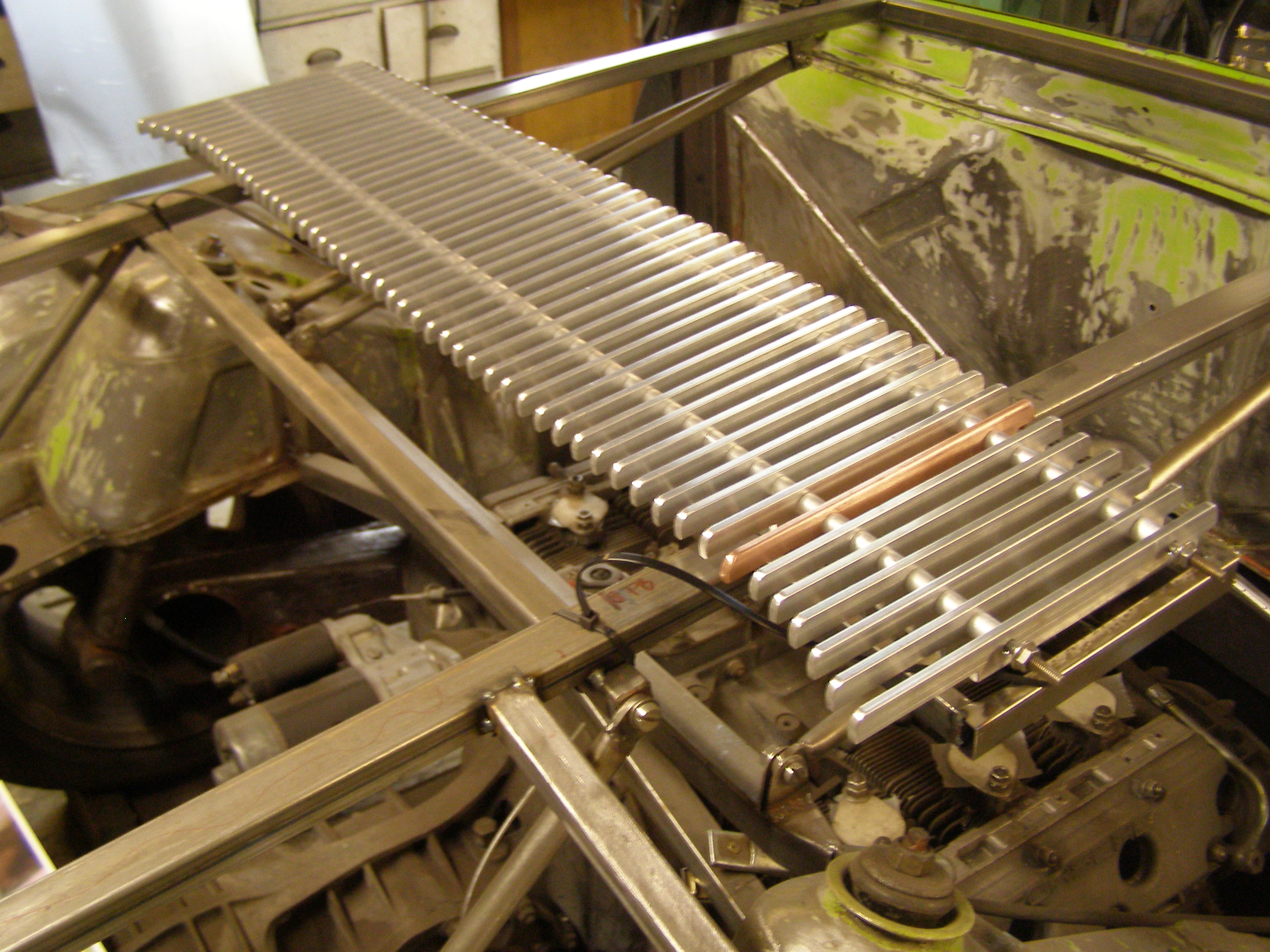

Engine lid grille is made from original parts....the distances are made from 914 pushrods.
