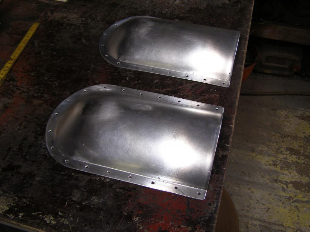

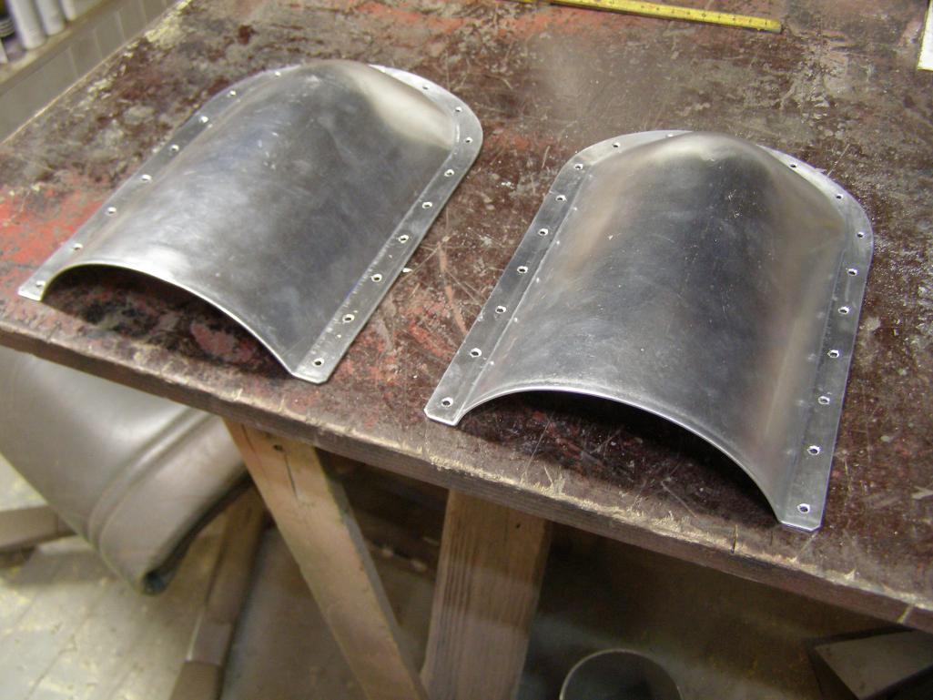

To get some practice with the material I made some air-scoops for the engine lid.Using them raw riveted over the paint when that day comes.....or punch some rows with louvers.
