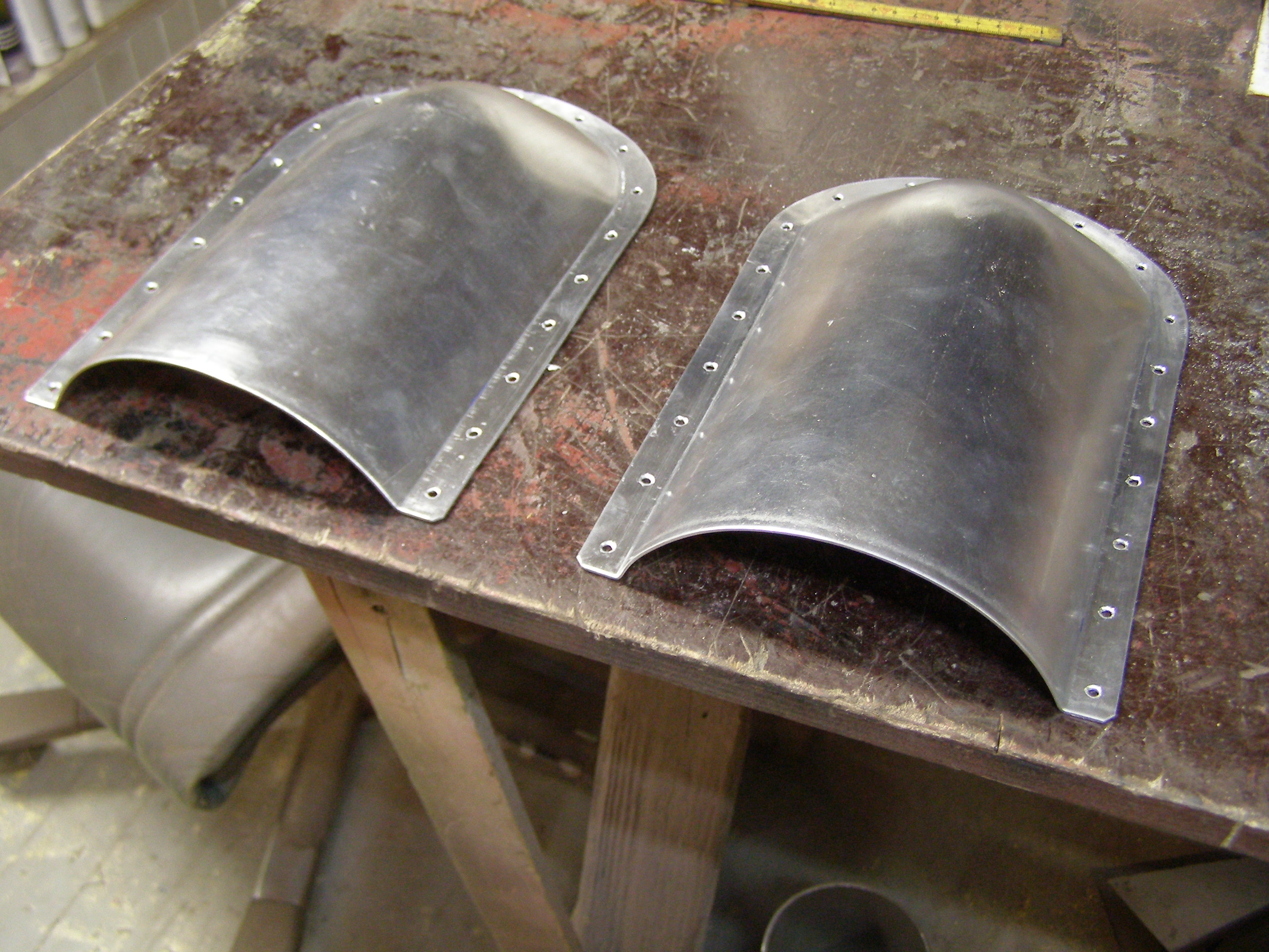

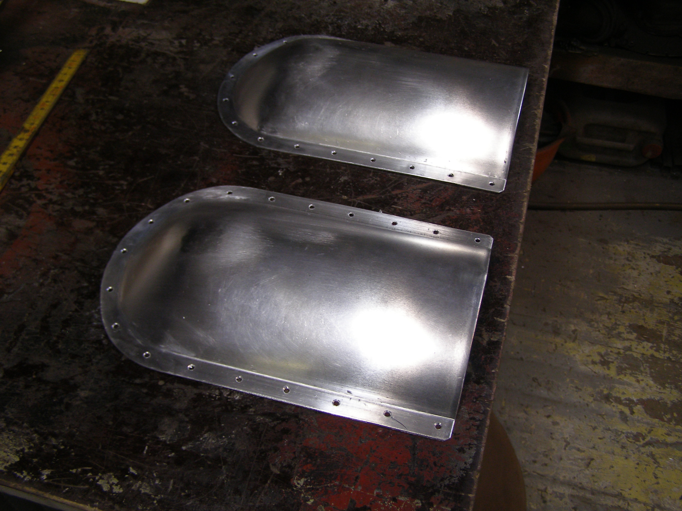

To get some practice with the material I made some air-scoops for the engine lid.Using them raw riveted over the paint when that day comes.....or punch some rows with louvers.

QUOTE(fordb132 @ Nov 29 2016, 07:22 AM) *
I love your work, would still love to see, what your using to form these.

fordb132   To get some practice with the material I made s...   Nov 29 2016, 06:22 AM
914forme   To get some practice with the material I made some...   Nov 29 2016, 06:26 AM
fordb132   The old lady next door had a piece from a garde...   Nov 29 2016, 07:28 AM
Krieger   Nice! You have excellent imagination and fab s...   Nov 29 2016, 08:28 AM
914forme   So did you cut a wedge out of the rounded end, and...   Nov 29 2016, 09:55 AM

fordb132   914 Forme...Yes I rolled a cylinder,cut into two h...   Nov 30 2016, 12:23 PM
