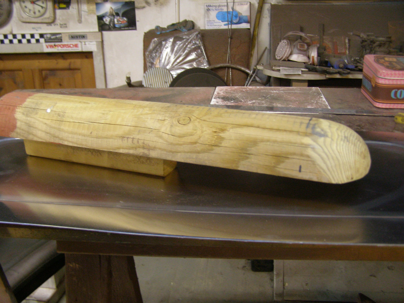

The old lady next door had a piece from a garden fence lying that I brought home while walking past.Put it in a vice and formed the end half-round and lots of careful hammering and a short TIG weld up to the top.
Would have been better to make a hammerform to hammer it into.
I was only making two,so I didn't take the time to make one of those.

fordb132   The old lady next door had a piece from a garde...   Nov 29 2016, 07:28 AM

914forme   So did you cut a wedge out of the rounded end, and...   Nov 29 2016, 09:55 AM

fordb132   914 Forme...Yes I rolled a cylinder,cut into two h...   Nov 30 2016, 12:23 PM
