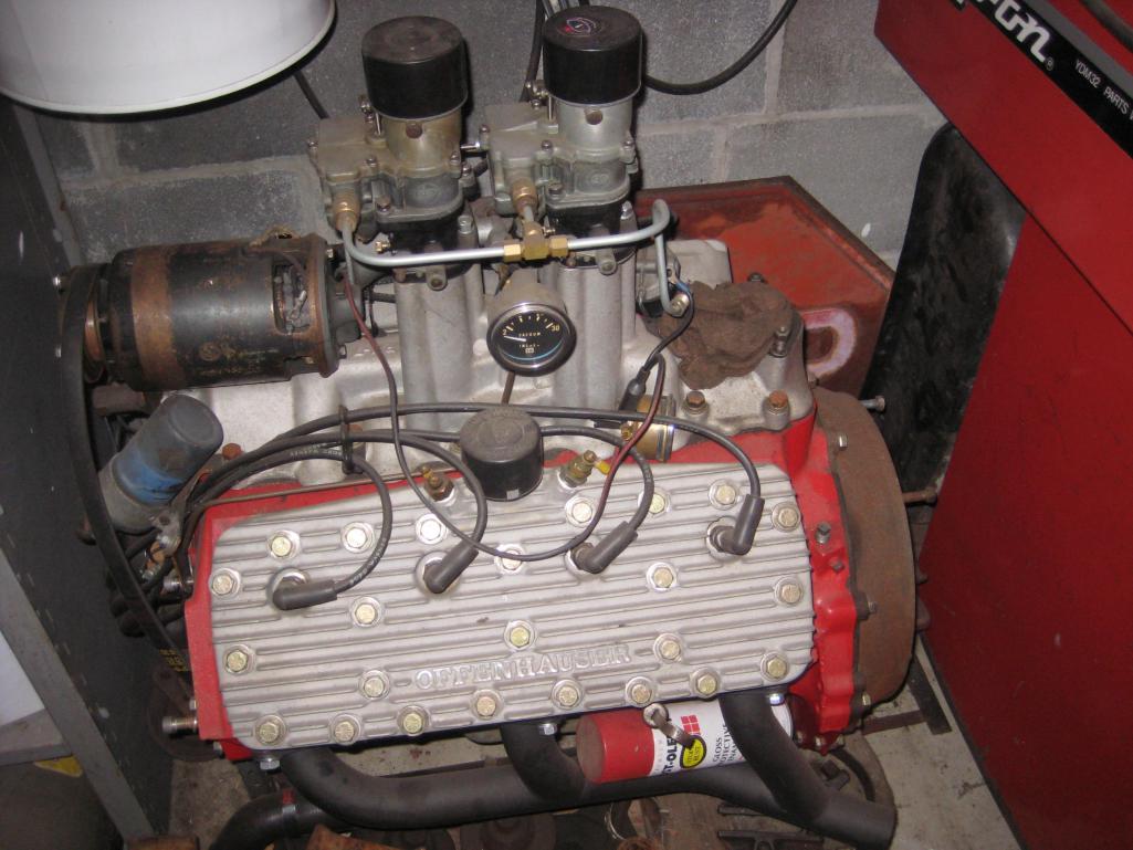

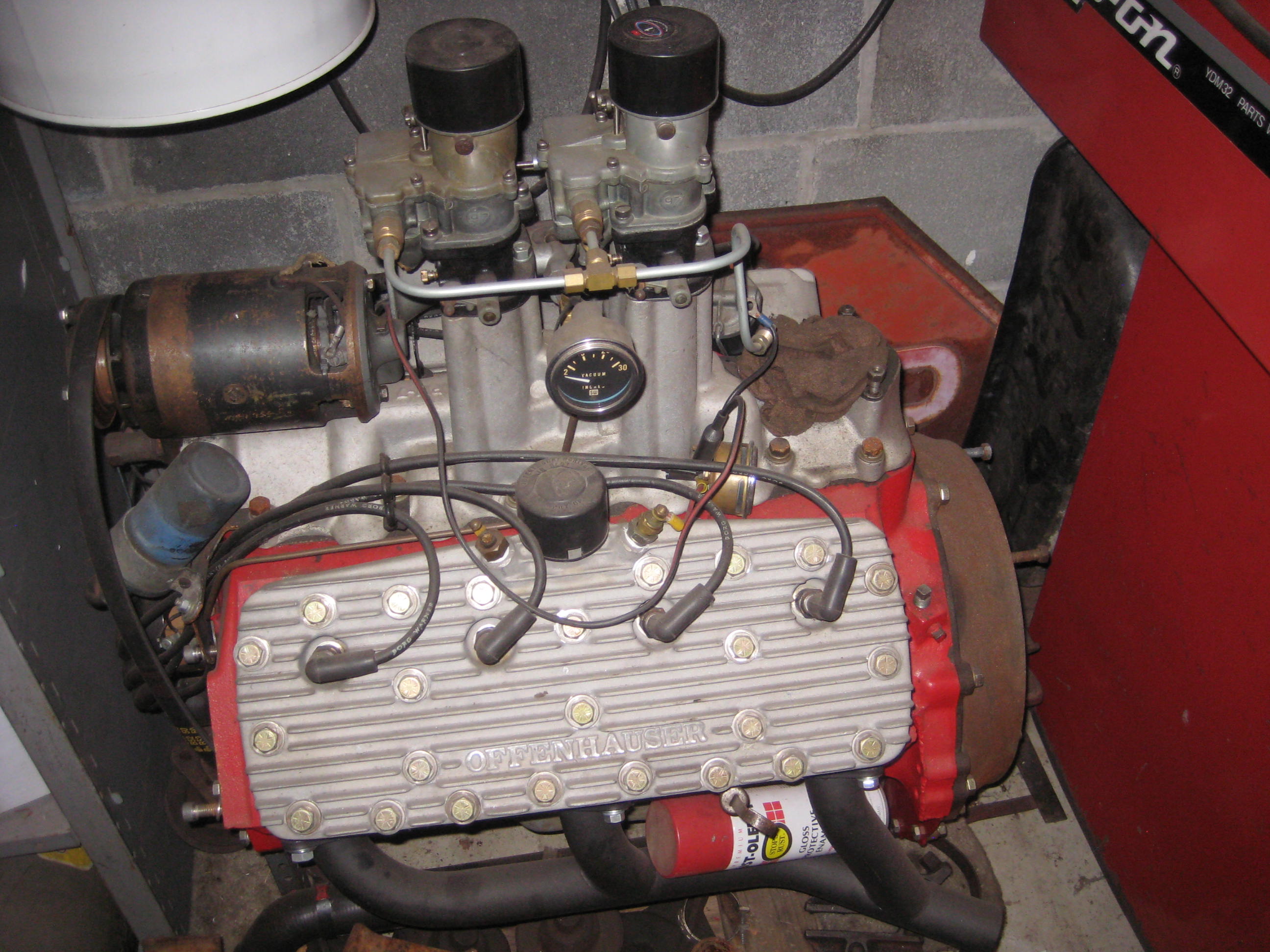

QUOTE(fordb132 @ Nov 29 2016, 12:21 PM) *
I do have with flathead 8.
Ah ha !
Your avatar gave me a clue. Attached is a pic of one of my projects (a 276" flatty in a '32 highboy)
Your skills are amazing.
I'm like others here, saw your starting point and what you said you were going to do.
I said to myself, 'Oh yeah sure, another crazy dream'
Wow !
Great work.
