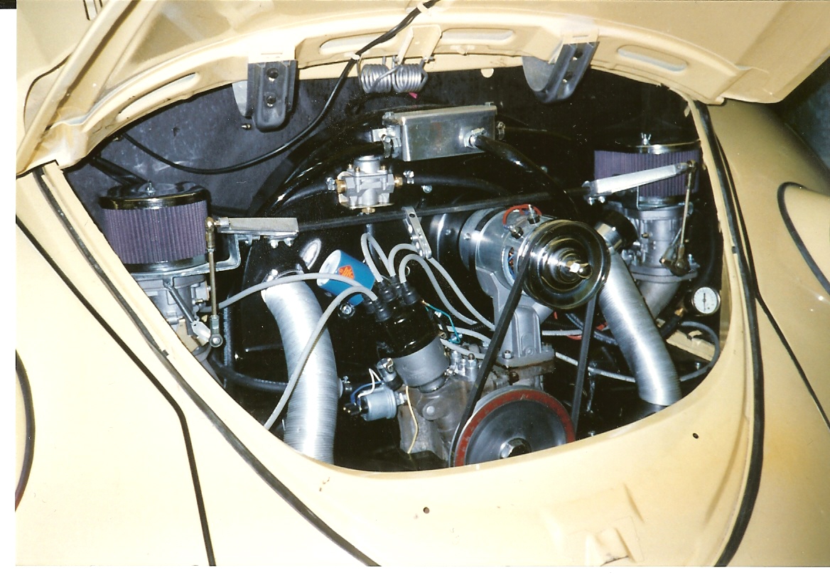

The pic below is of my old bug that had 44's with 36mm vents. It was a 1914cc engine that had Chevy 2.02 intake valves. I needed the large vents to reach 7K RPM. I built it for 8K RPM but never had the guts to spin it that fast and doubt I had the carbs for it. 48 IDA's were an option but scarce at the time.
I did lots of tuning to make them work. It took large accelerator pump jets, F7 ET's and float levels on the fine line of being too high. BTW it got about 6 mpg. Why go through that mess when you're not drag racing it. Note the Holley 1 in 2 out regulator and fuel pressure gauge. I had a Holley blue pump putting out 14 psi and needed to drop pressure to avoid lifting the float needle valves. Attached thumbnail(s) |
