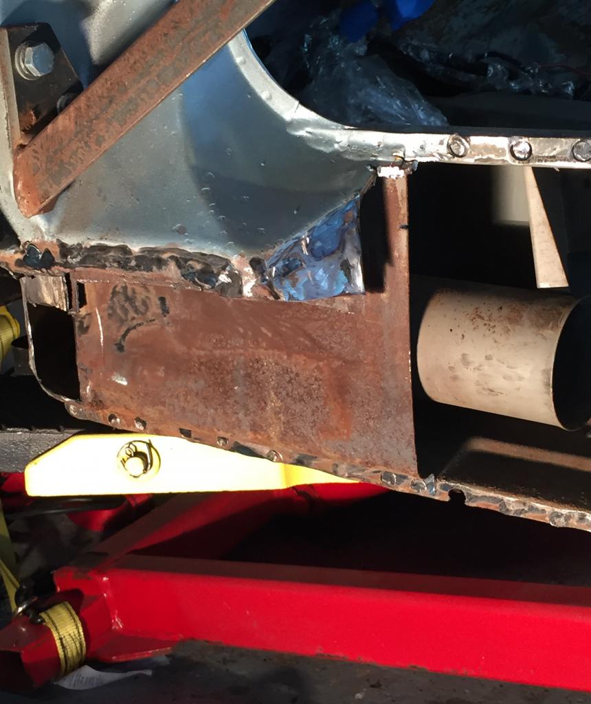

Cut away the remainder of the sill panel.
Surface rust on the extra panel in front of heater tube.
No issues there. Will make patch panel for lead edge of the long that you
see just inside the wheel well.
