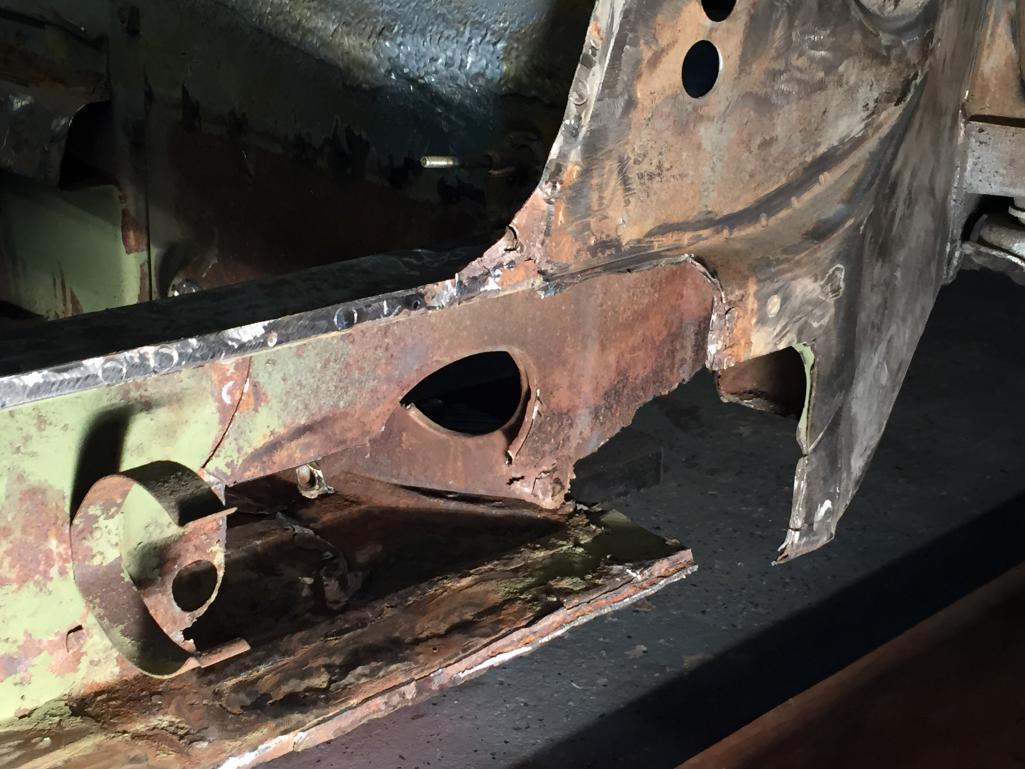

Removed more of the door jamb except for brace area.
Cut open seatbelt anchor region to take care of that and prepare for
placing in new steel.
I removed the left half of inner firewall just before
tunnel overlap. The tunnel is sound from what I can tell on probing and
scraping. Test fit the new panel of firewall. Should be real nice when complete.
The bronze brazing mixture on those E brake tubes are a bugger. Did my best
not to destroy them.
I'm at the point now that I'll be sandblasting all these
areas. I'm awaiting a call from Lowes for my new
compressor (Christmas gift). Then that will be the next
coming weeks chore.
