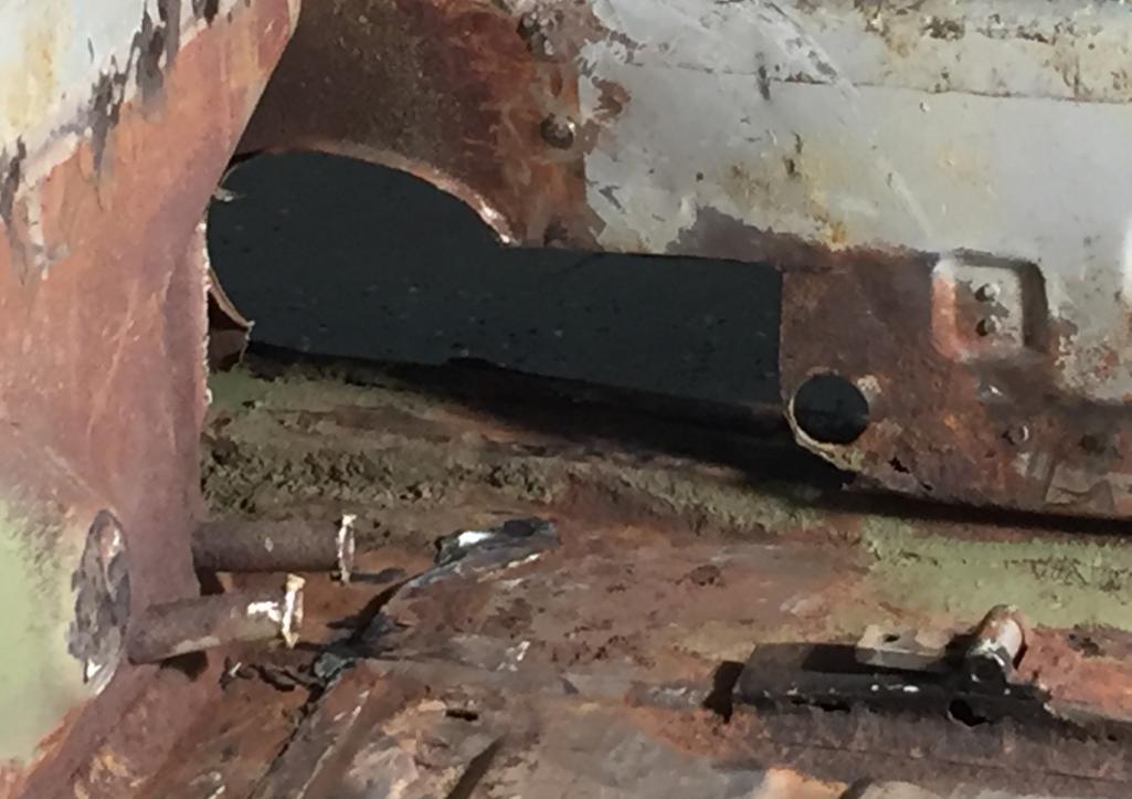

Dion   Ok, tar all scraped out. Door braces in place. Tim...   Oct 2 2016, 05:27 PM
Dion   Well did more exploratory surgery and it's ugl...   Oct 4 2016, 06:01 PM
Dion   Ugly   Oct 4 2016, 06:02 PM
Dion   :blink:   Oct 4 2016, 06:03 PM
Dion   <_<   Oct 4 2016, 06:05 PM
Dion   Opened up whole of left longitudinal today. I...   Oct 5 2016, 09:34 PM

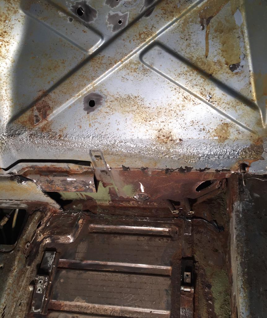

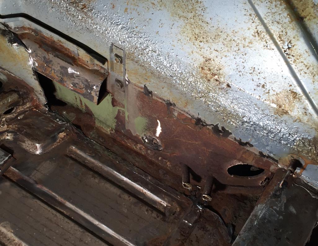

Dion   Cut away the remainder of the sill panel. Surface ...   Dec 1 2016, 01:29 PM
Dion   Removed more of the door jamb except for brace are...   Dec 1 2016, 01:37 PM
Dion   Pics   Dec 1 2016, 01:41 PM
Dion   Pics   Dec 1 2016, 01:43 PM
Dion   New firewall panel test-fit & de-brazed E-brak...   Dec 1 2016, 01:44 PM
