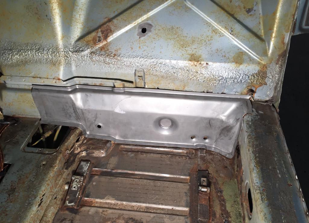

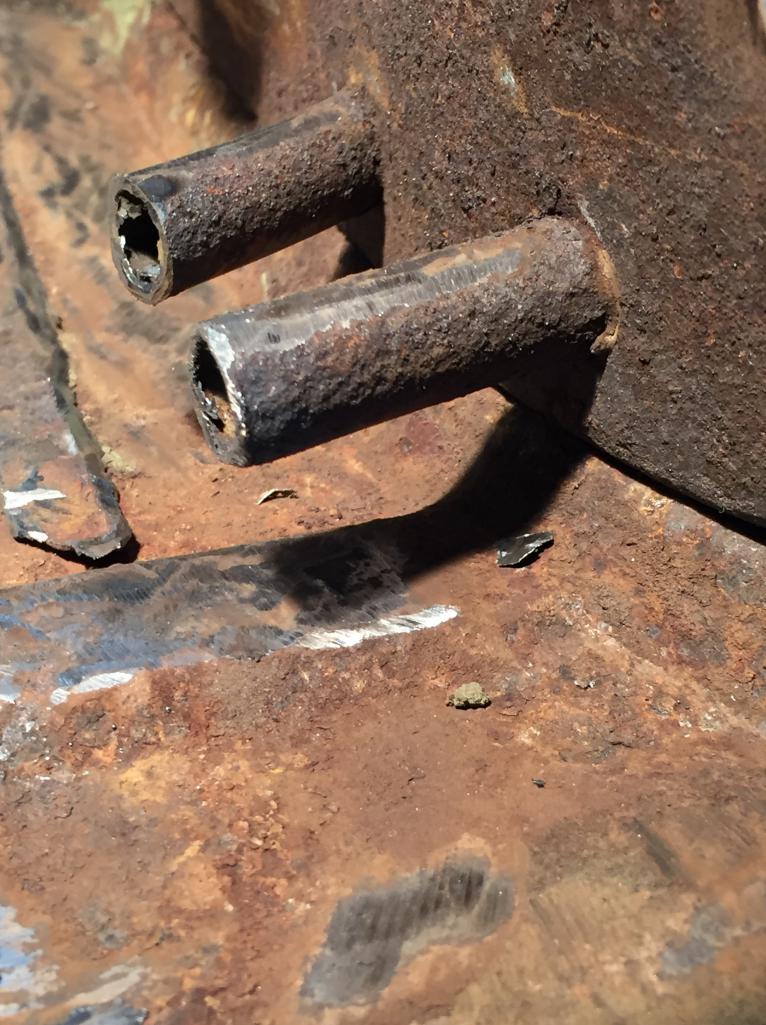

Dion   New firewall panel test-fit & de-brazed E-brak...   Dec 1 2016, 01:44 PM
tygaboy   I'm amazed at the level and extent of :sawzal...   Dec 1 2016, 01:46 PM
Dion   Thanks for that Chris. I'm the one that gets ...   Dec 1 2016, 02:01 PM
