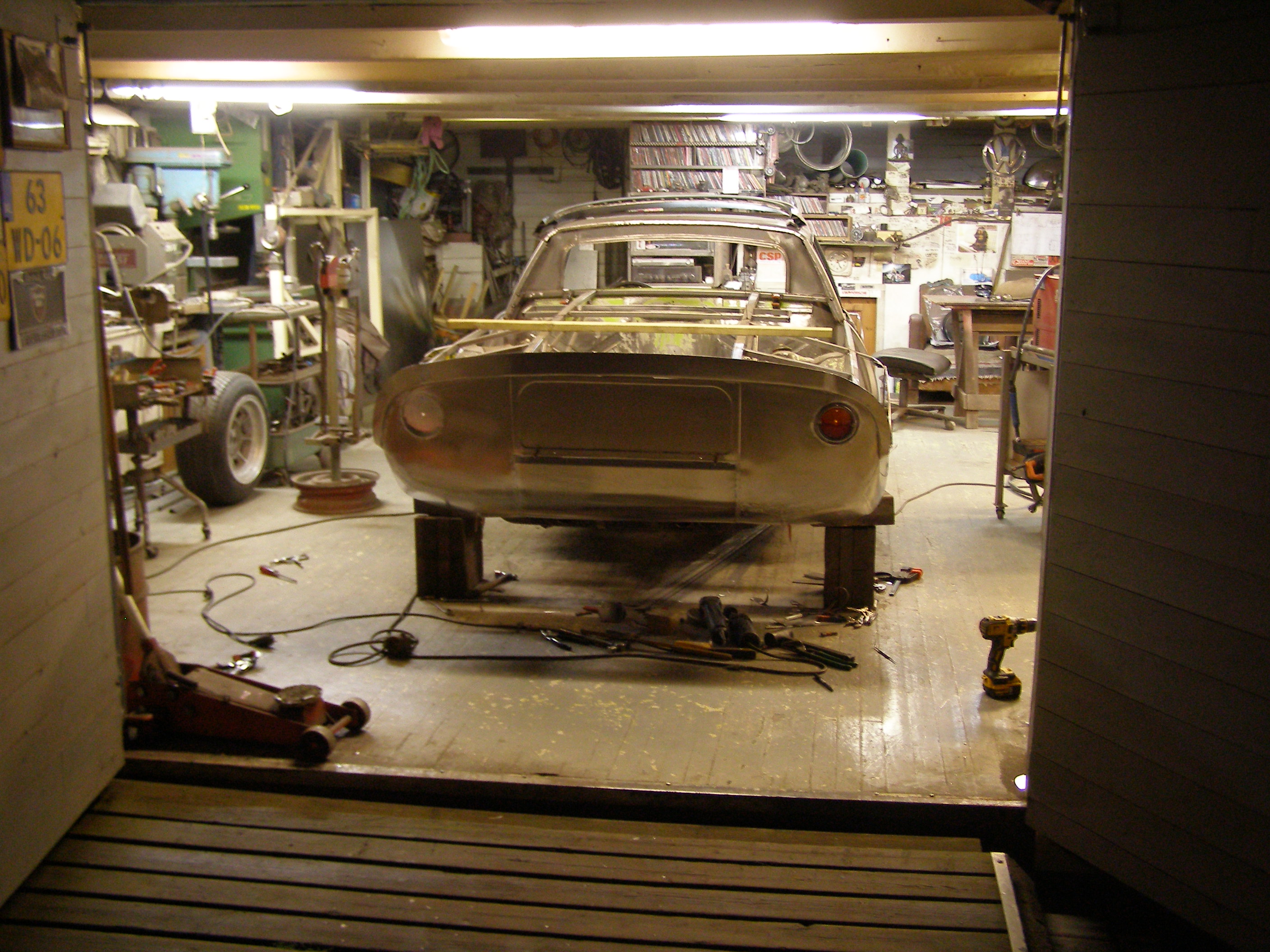

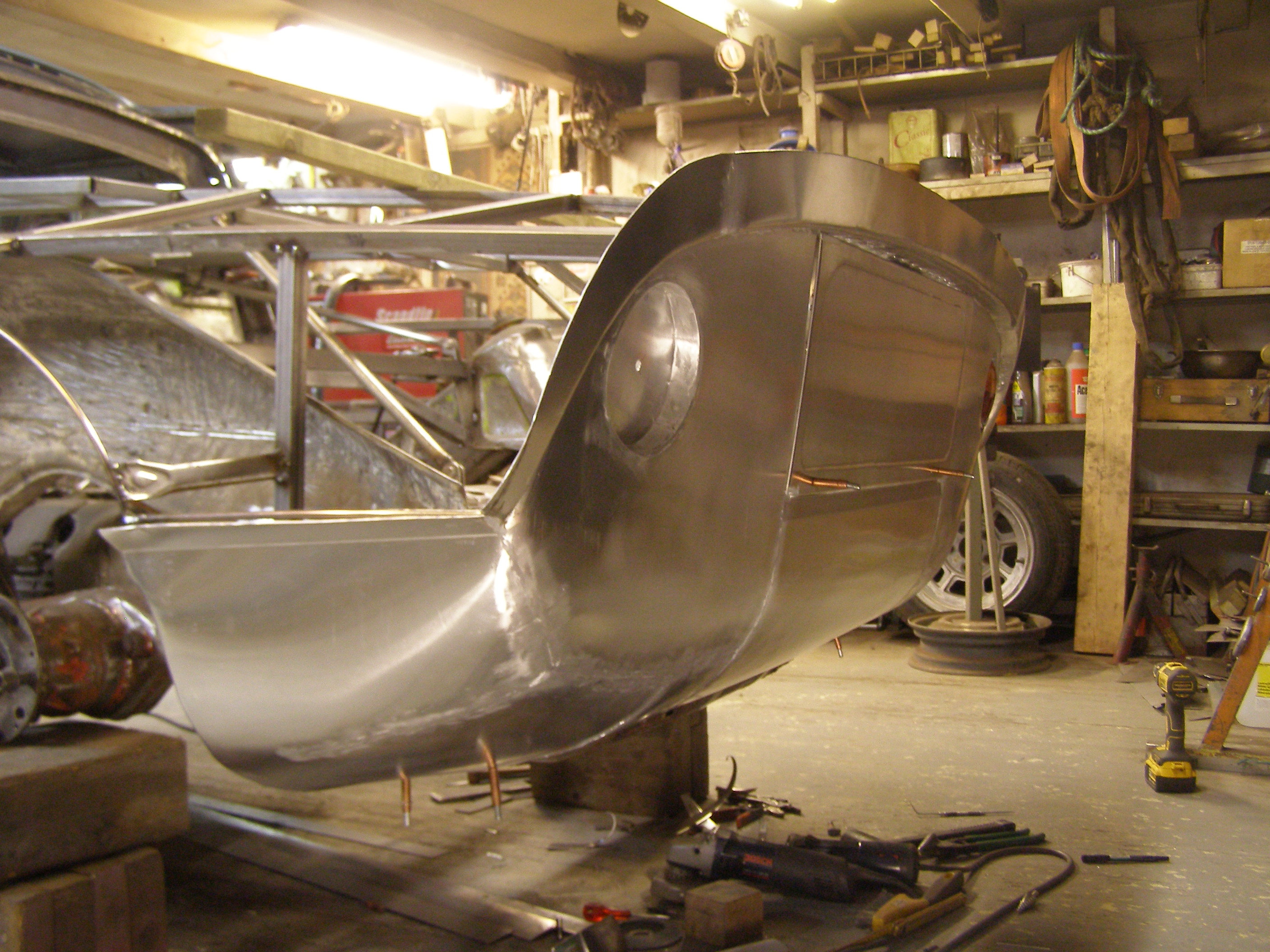

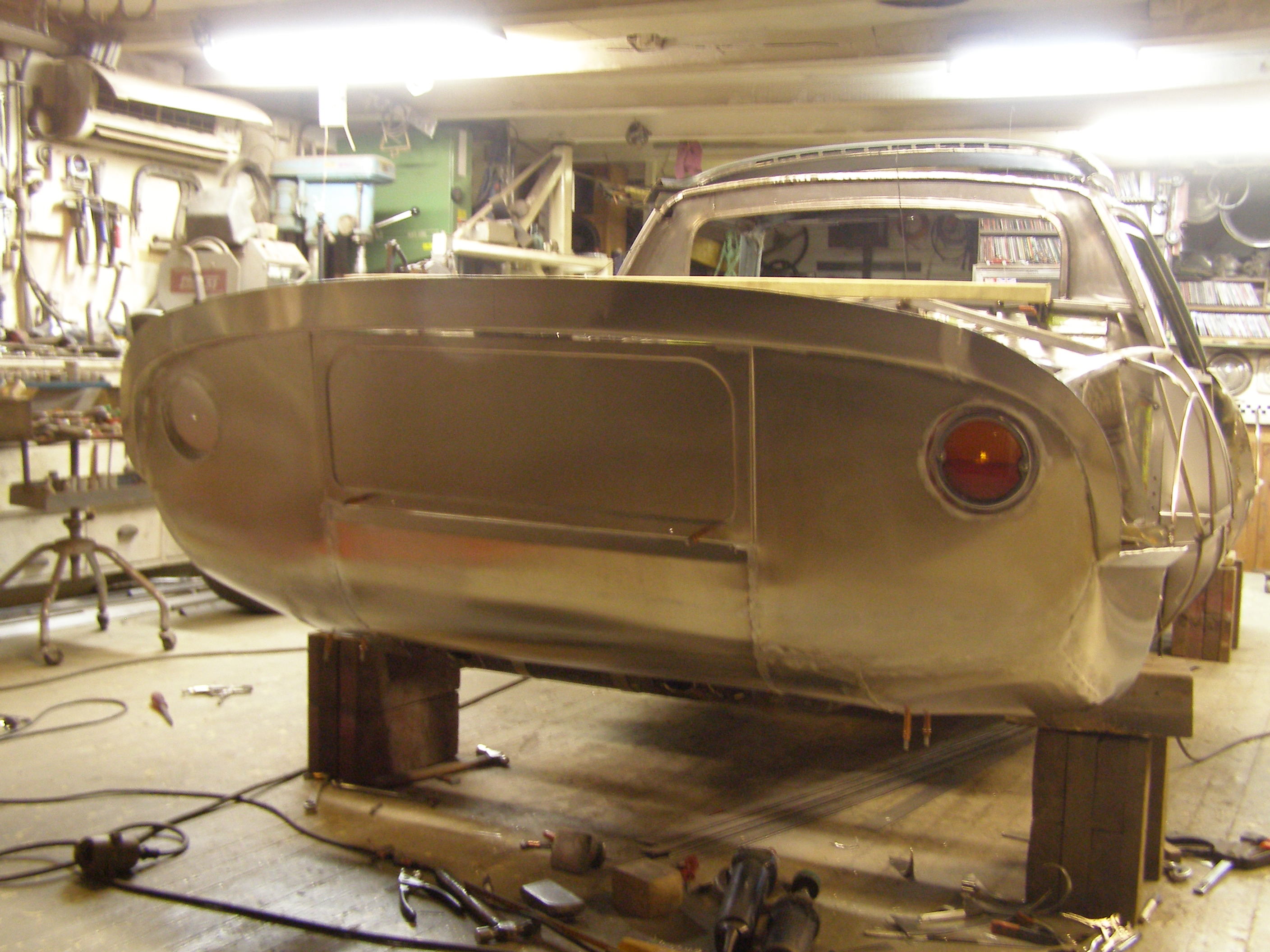

Some more lousy pics from my project.Would have been easier for me making it in steel,it turns out.Can't complain as I have been bragging about all the spare time I got....
Starting up front tomorrow,I think.Waiting for a new silencer so I can finish the lower bottom of the alu above the exhaust.
Whats you verdict...I have a bad taste of whiskey in my mouth.
