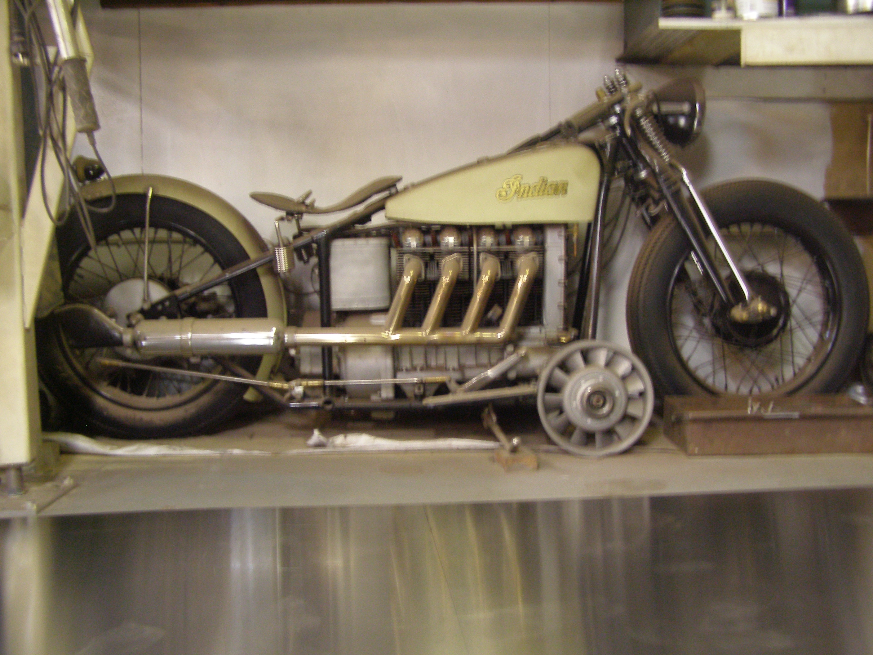

So you like german air-cooled...do you recognize this one:Attached Image
No the engine is a 2,0 that I want to put into the golden 914 and it was not part of the deal.For 300 usd I got the title and a shell.I have a 2,4 with webers that is going into this creation.
No,I'm not retired...the workshop is,dough.I bought from an american cabinet maker as a young man in 1990 and it's warm enough if you keep yourself a little busy.
