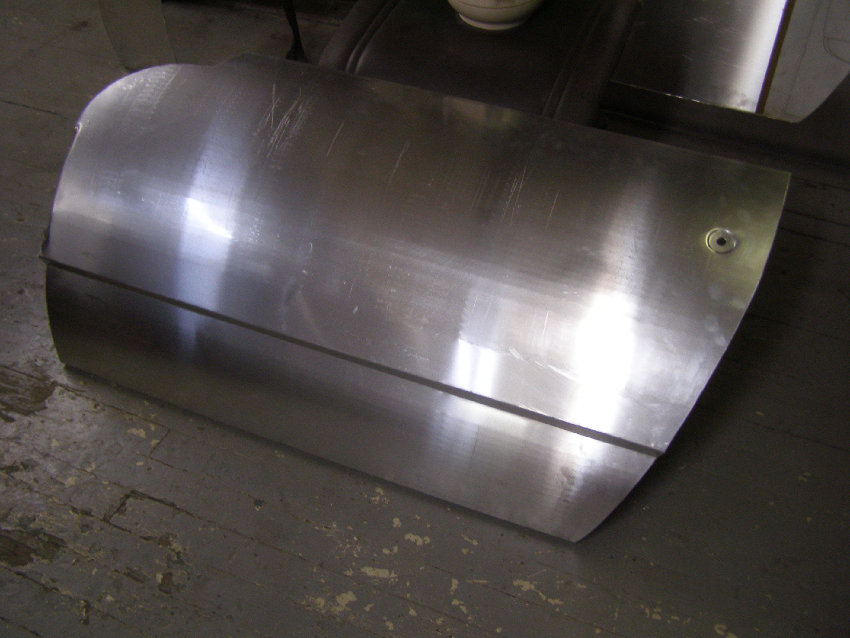

fordb132
post Dec 13 2016, 03:46 AM
Posts: 65
Joined: 23-January 16
From: Norway
Member No.: 19,591
Attached Image Made door skins with a brake.Looks good so far.
Exciting times.....

fordb132   Made door skins with a brake.Looks good so far. E...   Dec 13 2016, 03:46 AM
Frankvw   you.handmade.a.doorskin.in.less.time.than.to.order...   Dec 13 2016, 05:50 AM
fordb132   I don't think you can order any metal parts fo...   Dec 13 2016, 06:19 AM
MrsWannaB   It's just me,my restless soul and occasionall...   Dec 13 2016, 02:03 PM
mbseto   As I look at that door skin, I'm guessing each...   Dec 13 2016, 08:11 AM
zambezi   As I look at that door skin, I'm guessing eac...   Dec 13 2016, 12:44 PM
blackmoon   Simply amazing, great work taking on a rust bucket...   Dec 13 2016, 10:47 AM
fordb132   Hi all and thanks for the comments everybody.Yes y...   Dec 13 2016, 02:28 PM
