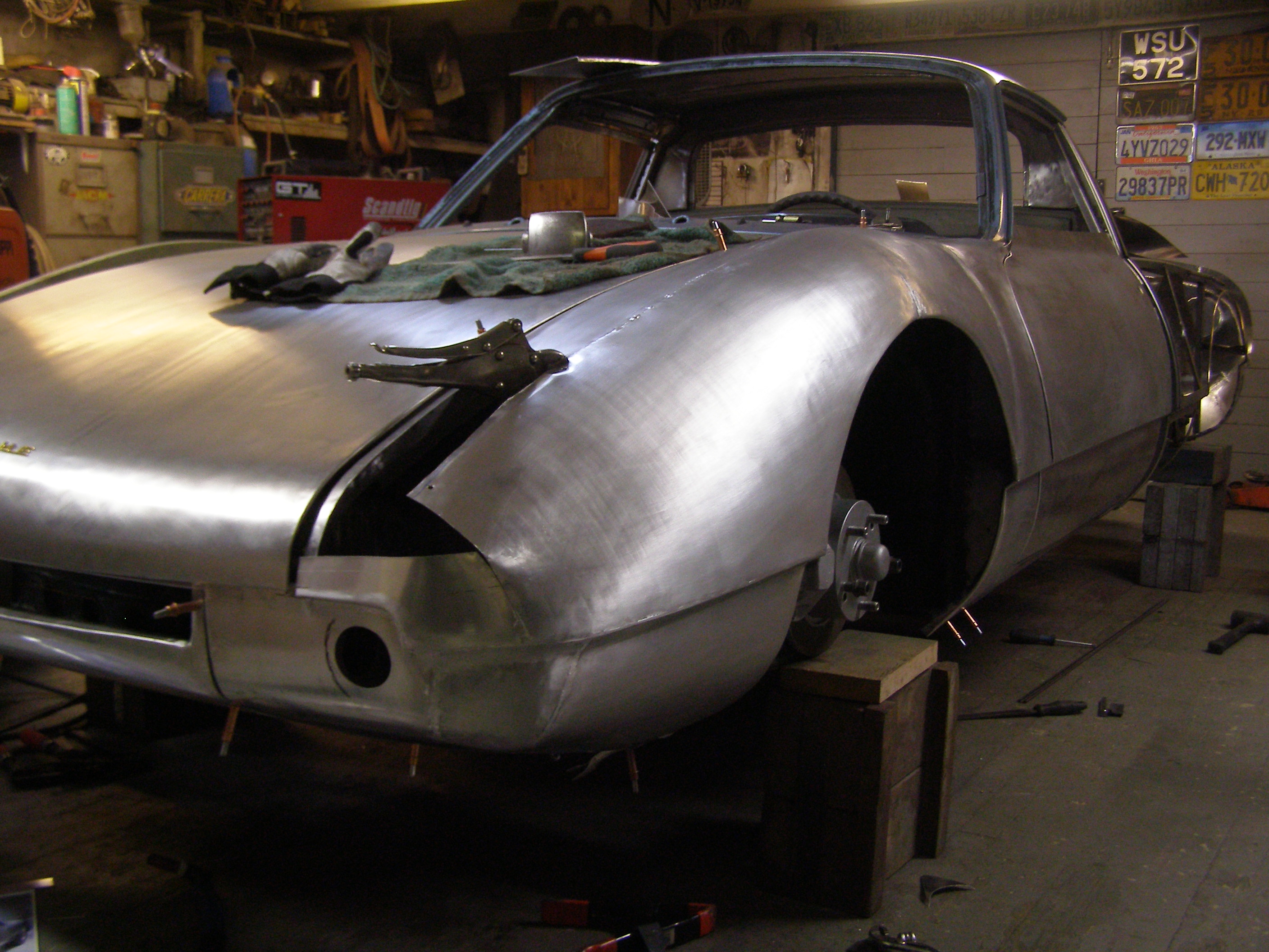

fordb132   Started on the first front fender today. Looks li...   Dec 9 2016, 05:00 AM

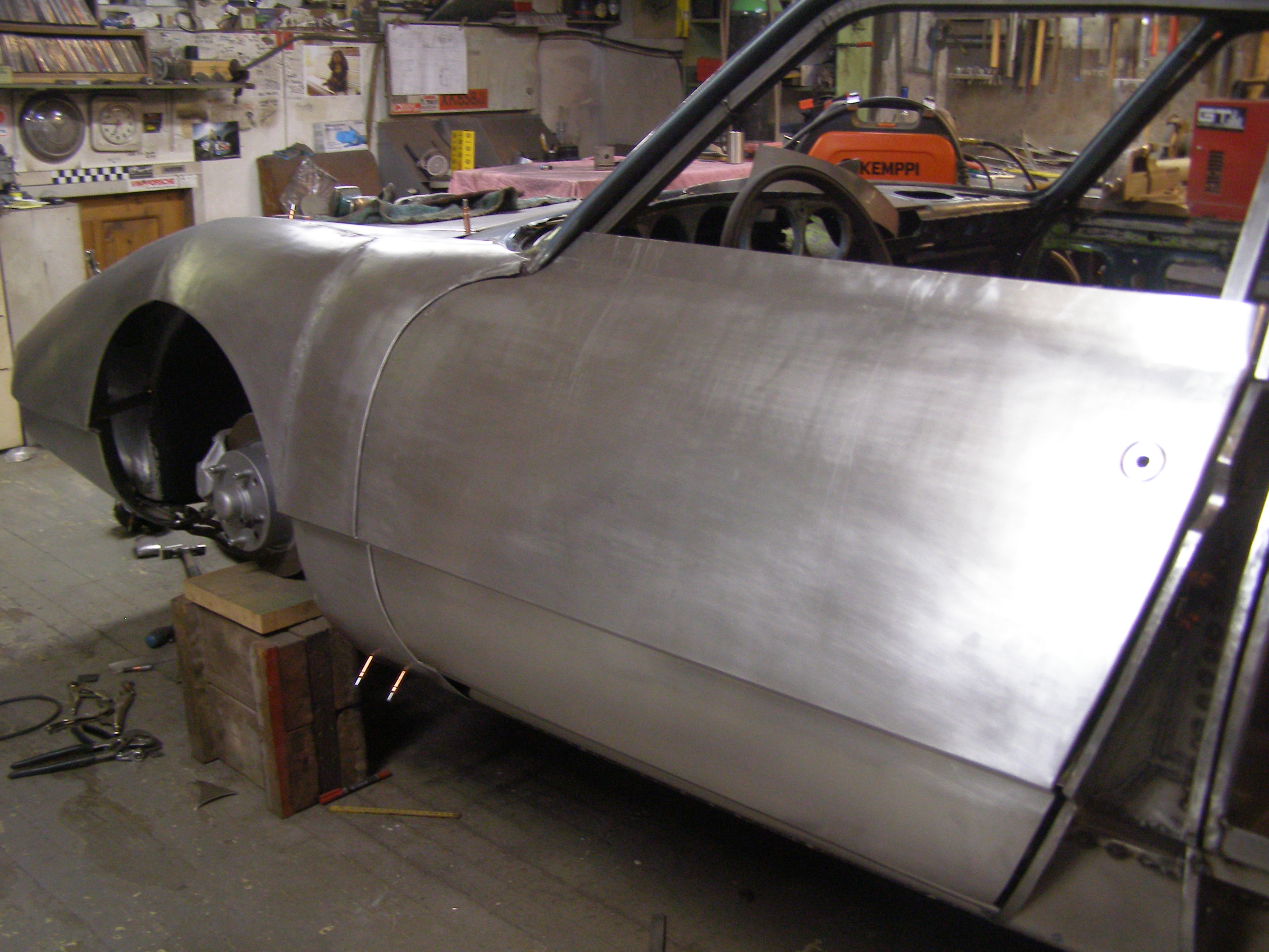

fordb132   Made door skins with a brake.Looks good so far. E...   Dec 13 2016, 03:46 AM
Frankvw   you.handmade.a.doorskin.in.less.time.than.to.order...   Dec 13 2016, 05:50 AM
fordb132   I don't think you can order any metal parts fo...   Dec 13 2016, 06:19 AM

mbseto   As I look at that door skin, I'm guessing each...   Dec 13 2016, 08:11 AM
zambezi   As I look at that door skin, I'm guessing eac...   Dec 13 2016, 12:44 PM
