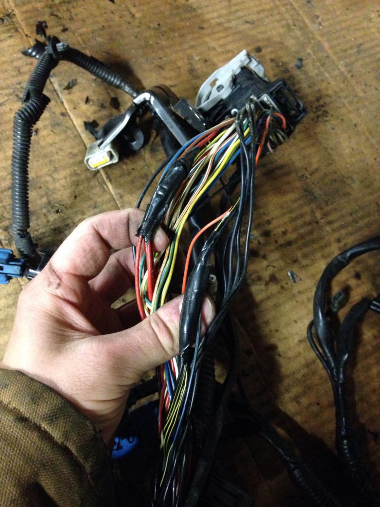

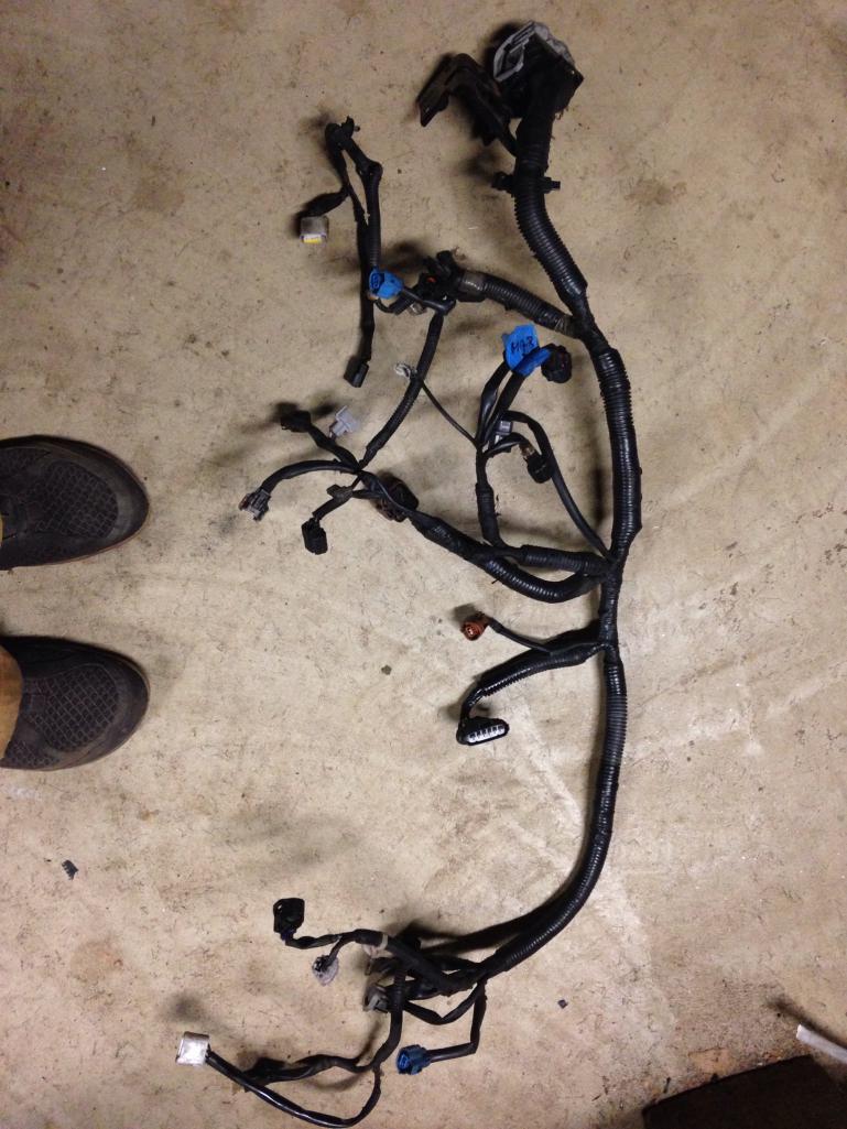

Also pulled the intake wiring harness off. With all of the zip ties and hard to get to connectors, it was a bit of a pain. I didn't take a picture, but this car doesn't have a MAF installed (thought all of these did...need to do some more reading there), but did have the associated connector and a pretty slick sealing blank on the loom.
It contains most everything (engine-wise) besides the camshaft phasing controls (AVCS), crank position sensor, and coil driver wires. I was expecting the harness to be perfect given it came off a motor only 11 years old (IMG:style_emoticons/default/laugh.gif), but it had some issues. It looks like someone has been into it before and cut/spliced some wires. Its a little strange since they didn't make any changes; perhaps they were trying to do some troubleshooting and didn't have the correct probes.
Next step is to identify all of the connectors and reverse engineer the harness to start building a new one. The plan is to build a separate intake and engine block harnesses with firewall bulkhead connectors for fast engine removal. We'll see how that works out!

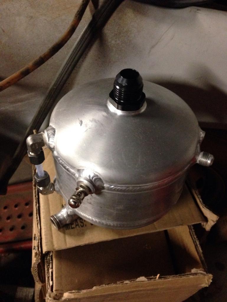

My cheap NASCAR expansion tank arrived. Buying a used tank was cheaper than buying the nice almost-but-not-quite hemispherical tube caps, so I went for it. It'll go nicely with the NASCAR bar. (IMG:style_emoticons/default/laugh.gif) I'm pretty stoked to weld on some mounts, loose the lower wiggins fitting, and go to town with it.
