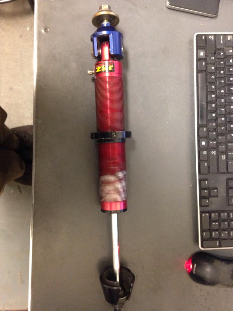

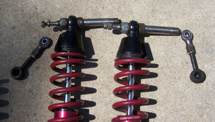

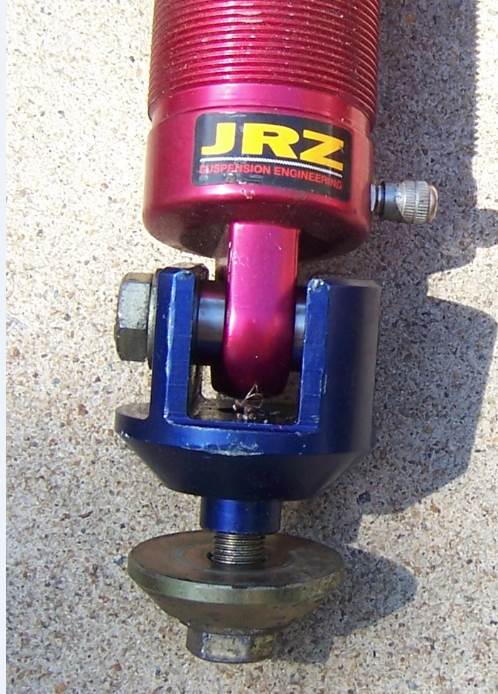

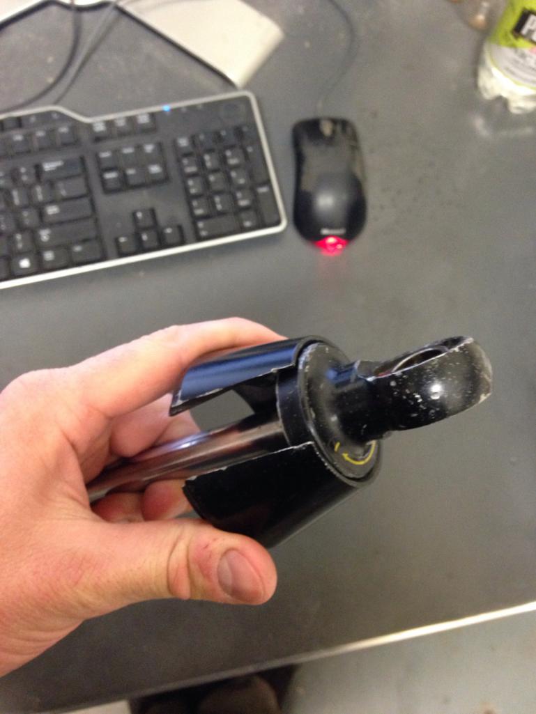

I got a sweet set of single adjustable JRZ shocks for the rear from Stephen (914forme). (IMG:style_emoticons/default/smile.gif)
They take 2.25" springs-my old shocks took 2.5" so I'll need to get some new springs. The rod-end spring perches are pretty nice in that they fit to the eyelet. The trailing arm attachment bolt is a pretty nice piece as well. These should work well with the raised "stock" shock console I'm planning.
Notes for later: Perch thread dimension is said to be M52x1.5. That is incorrect because the major diameter of the threads is ~2.1565 vs 2.046" (51.97 mm) it should be for that thread.

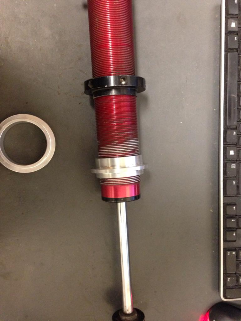

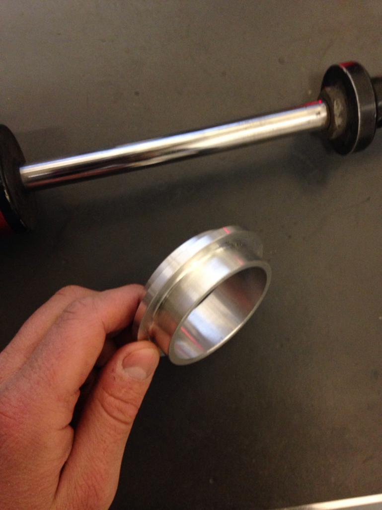

This morning I turned down some 6061 spring spacers so I can run a zero-weight helper spring and avoid having the main spring come off the perches when the car gets jacked up. The smaller lip is for the helper spring and larger for the main coil. These are going into the pile for anodizing now.
