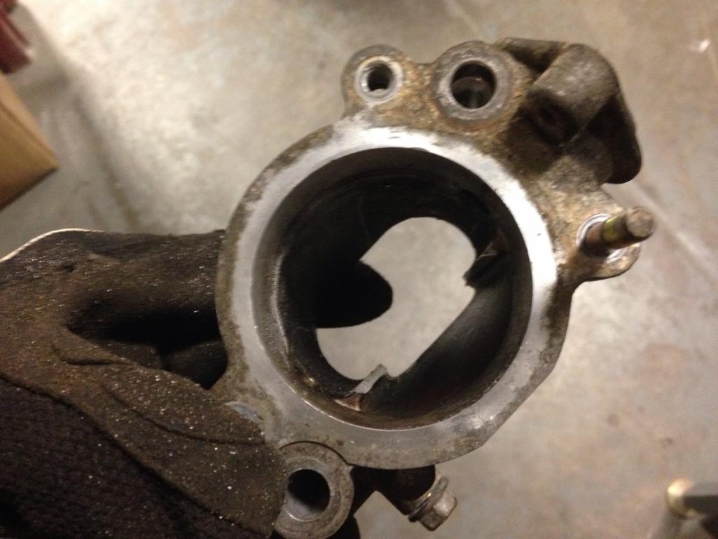

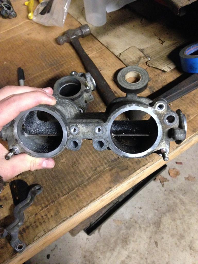

Next up are some TGV deletes. I really just started going through these so I could reduce the I/O on my ECU, not so much for any huge power gains. A bunch of companies sell nice milled versions for not too much money considering the machining complexity (IAG ~$300), but I'm way to cheap to buy them so I decided to do them myself. A lot of people just remove the butterfly valves like in the first pictures below, but given the difficultly to remove it seemed worth it to tally delete the crossbars and smooth the lip the butterfly sits on when closed.
Note: theoretically, the engine probably won't run as well at low revs (especially while cold) with these deleted. When closed they basically reduce the size of the runner dramatically to increase the velocity of flow hitting the injection stream. The increase in velocity would result in increased droplet entrainment, or better mixing. The fuel jet is essentially a jet in crossflow so increasing crossflow (runner) velocity decreases the momentum ratio of the injector stream and should cause it to bend over and not hit the back wall as hard.

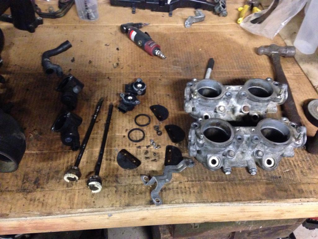

To delete you basically just:
1) Remove the TGV assemblies-easiest if you first remove the fuel rail
2) Remove the butterflies. Easiest way is to drill out the peened back side of the screws and then use an impact screwdriver on the front. Otherwise you can also just drill out the screws all together.
3) Remove all of the hardware (actuator, position sensor, etc.)
4) Tap out the shaft
5) Use a hacksaw to cut the "cross brace" as close to the inside surface as possible
6) Pick up your favorite die grinder and flame burr and go to town on the remaining brace. While you're at it you might as well smooth the butterfly plate lip. It's easiest if you mount in a vice and then use some beeswax, cutting oil, or machine coolant on your burr so it doesn't gum up.
7) Weld up the shaft holes.
8) Grind welds down smooth and go over whole interior with sanding wheel.
9) Clean up whole TGV body and reinstall (or whatever)

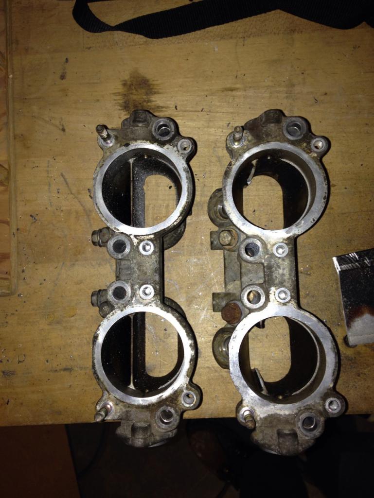

Disassembled on the bench (4):

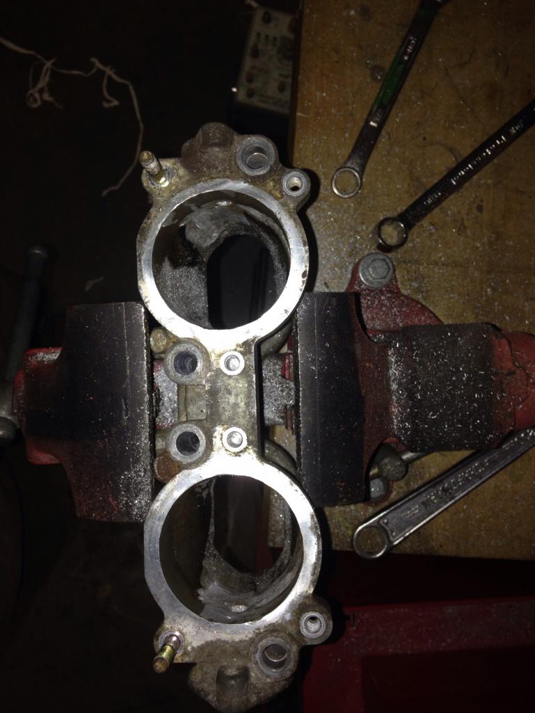

Shot of the cross brace inside before cutting and comparison after cutting (5).
You can see the little lip mentioned in (6) on the opposite side of the TGV interior as the cross brace.

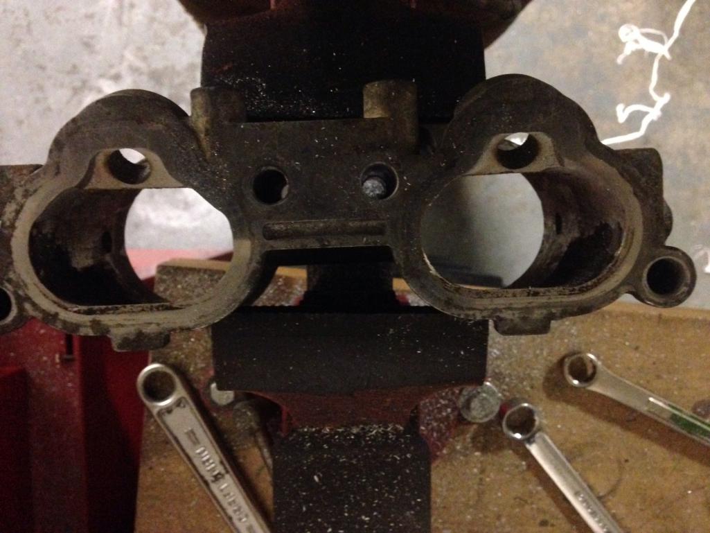

Mounted in the vice after some grinding (6).
