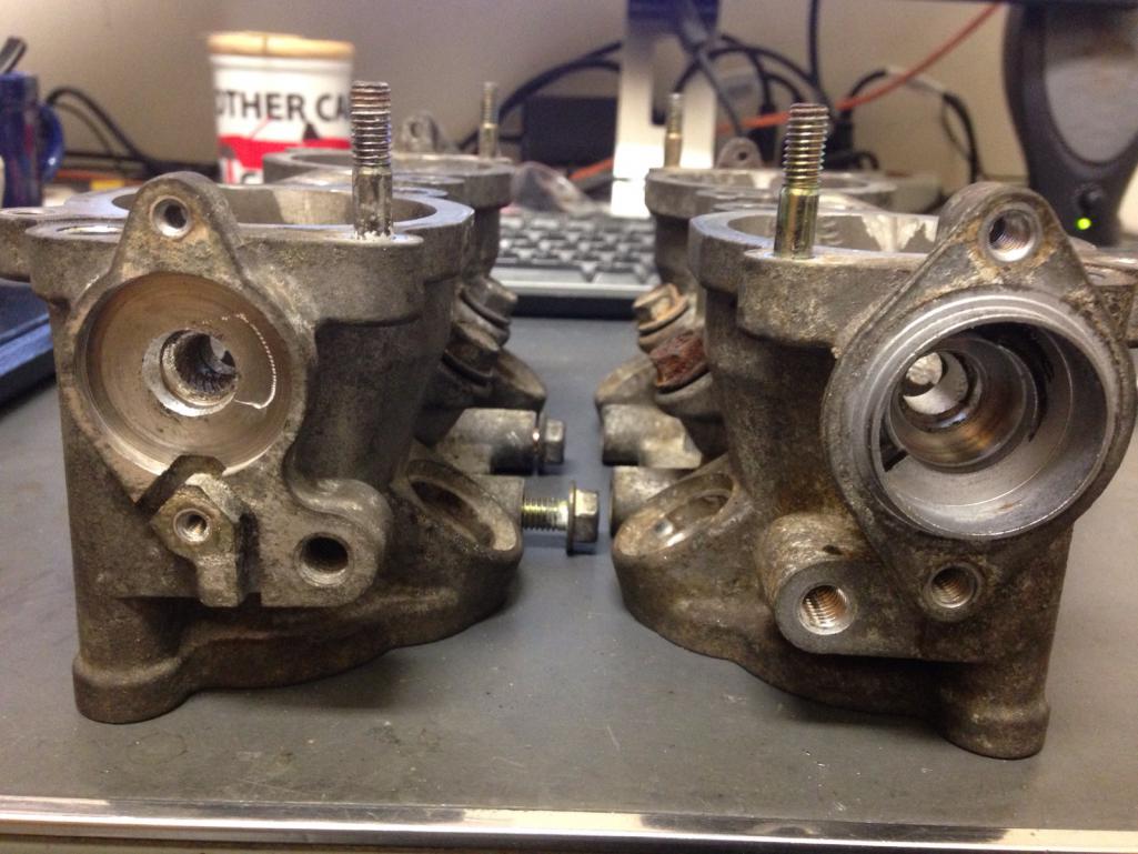

Another view of the material taken out with slightly better lighting.
The last step is to weld up the shaft holes and do a bit of sanding to remove any small gouges left from the die grinder. The shafts do ride on plastic bushing which are pretty easy to grind out with the grinder (I couldn't get them out by hand, not sure if that's typical or not). I'm probably going to blast these too to try and get rid of some of the oxidation and then paint or something to keep them nice.

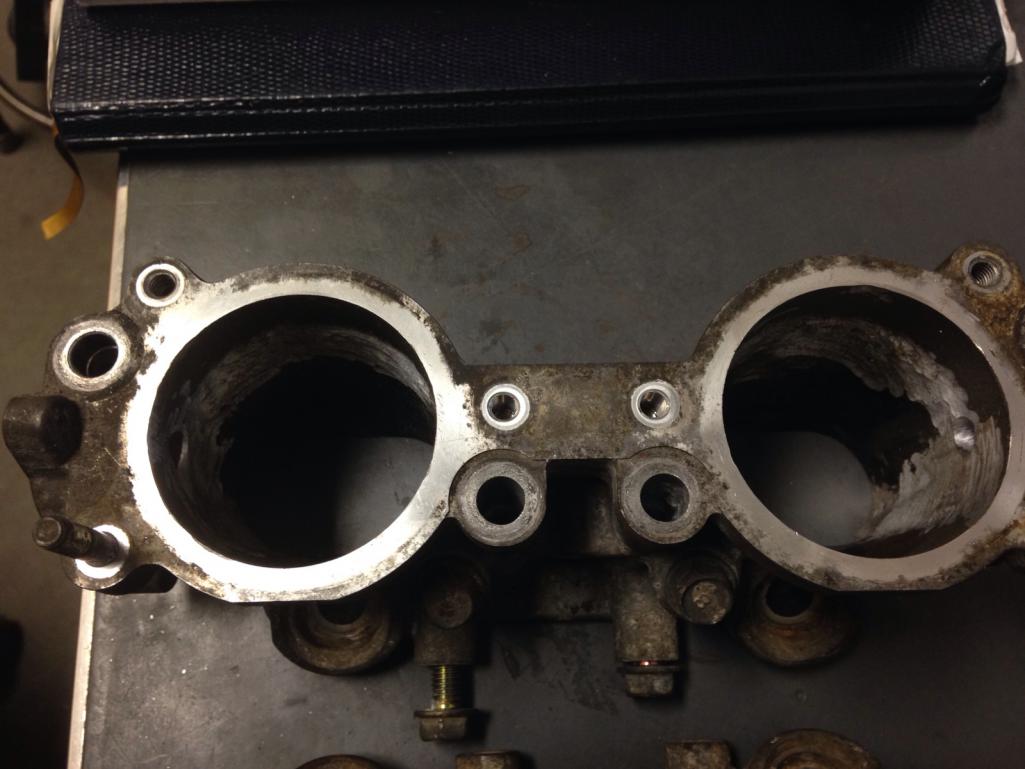

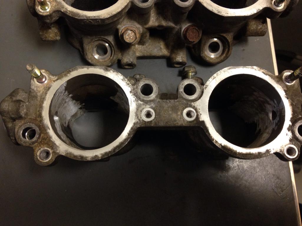

jd74914   Next up are some TGV deletes. I really just starte...   Dec 22 2016, 05:22 PM
jd74914   Another view of the material taken out with slight...   Dec 22 2016, 05:26 PM

jd74914   Finished the TGV removal finally! One more par...   Jan 4 2017, 04:54 PM
jd74914   The final product after hitting it with a 60-grit ...   Jan 4 2017, 04:56 PM
