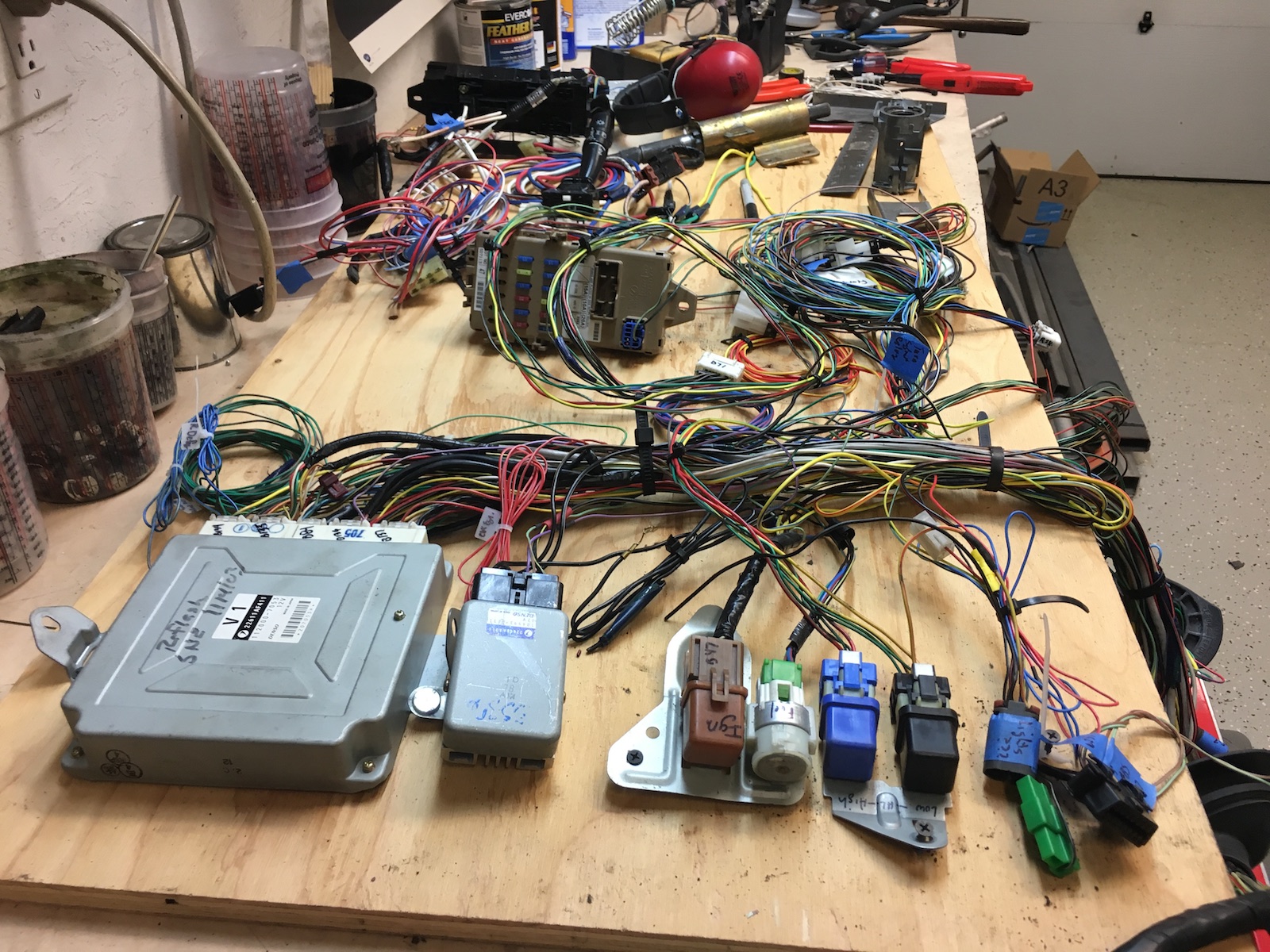

Big update: Wiring.
About a month ago I was able to pick up a 2002 wiring harness from eBay. Luck smiled on me back around Thanksgiving and my local junkyard had a 2002 WRX in the lot and I was able to scrounge the complete rear harness, fuel pump controller, turn signal stalk, and a few other various bits for $50. Found an engine fuse panel on eBay and *boom* I've got the complete harness.
~40 hours later and I've finally got the harness all trimmed down and ready for installation.
My advice: Print out the complete wiring diagrams and become extremely familiar with them. Label every connector. Once confirmed what things are, start trimming. EASY. Haha.

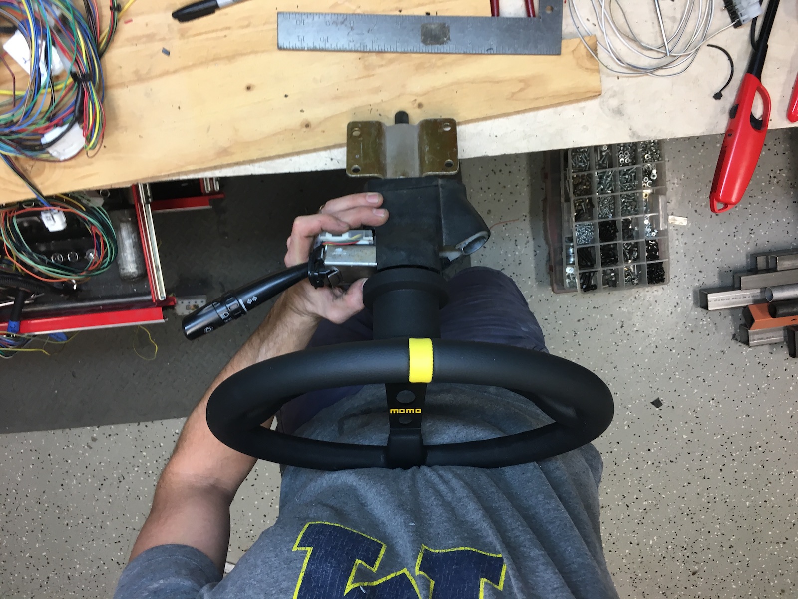

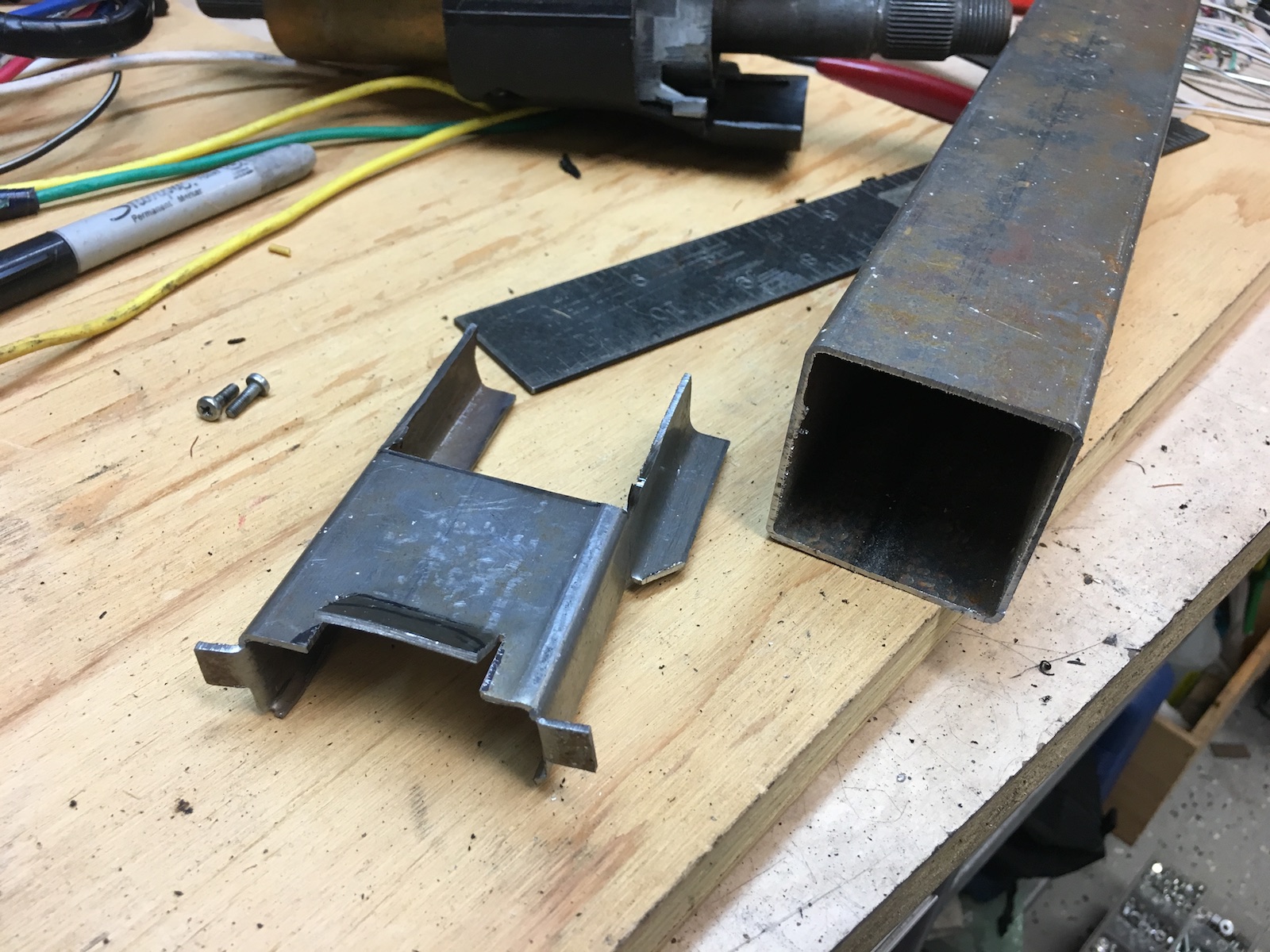

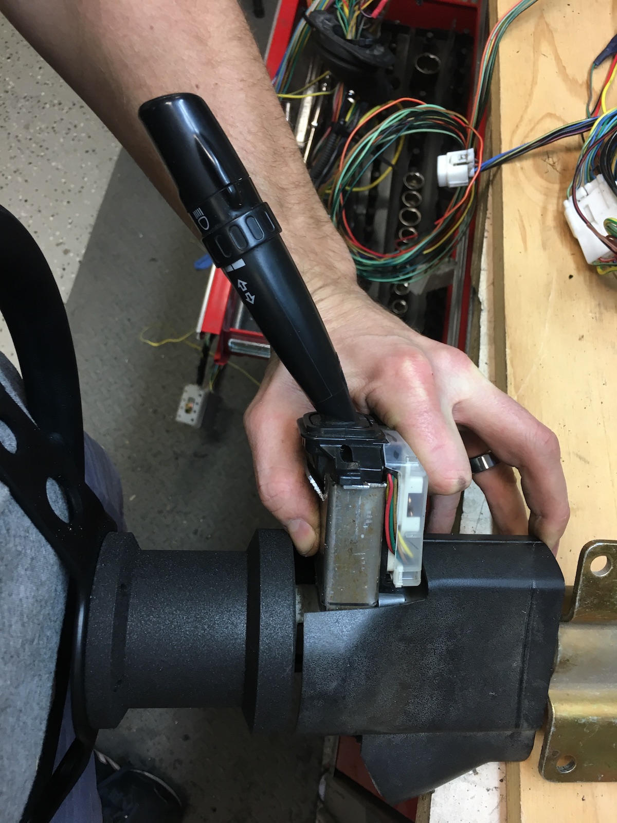

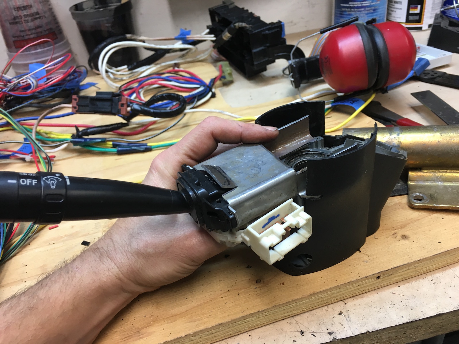

Anyways, today I had the day off so I finished up the work on the harness. I've got all the mystery wires identified and marked, all the connectors are trimmed down, and its basically ready to put in the car. Im, of course, going to wire-wrap the whole thing and mount it all to a board before installation, blah blah blah, but the trimming part is done. Phew!
I also had some *spare* time on my hands tonight so I started making the mount for the WRX turn-signal / headlight stalk to mount to the existing 914 steering column. I removed the old controls from the 914 column, including the old tumbler and wheel lock. The mount is made from some 2x2 that I had laying around. Bunch of cutting and bending and I've got a pretty good mount.
The detail work on this stuff will take some time but the bulk is finished. Feeling pretty good about mounting it all in the car next week.
Thanks for following along!
