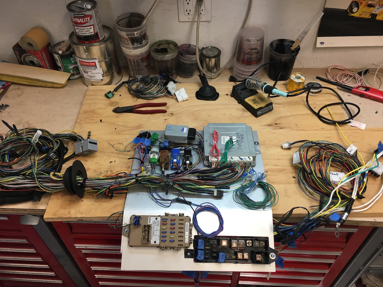

Mounted all the wiring to an aluminum panel which will go behind the driver seat.
Im going to wrap everything in weaved wire wrap before install, should be pretty pimp.
