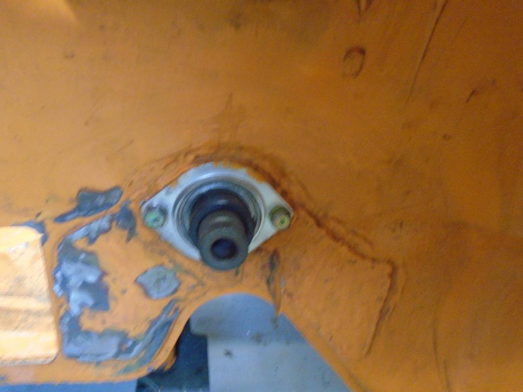

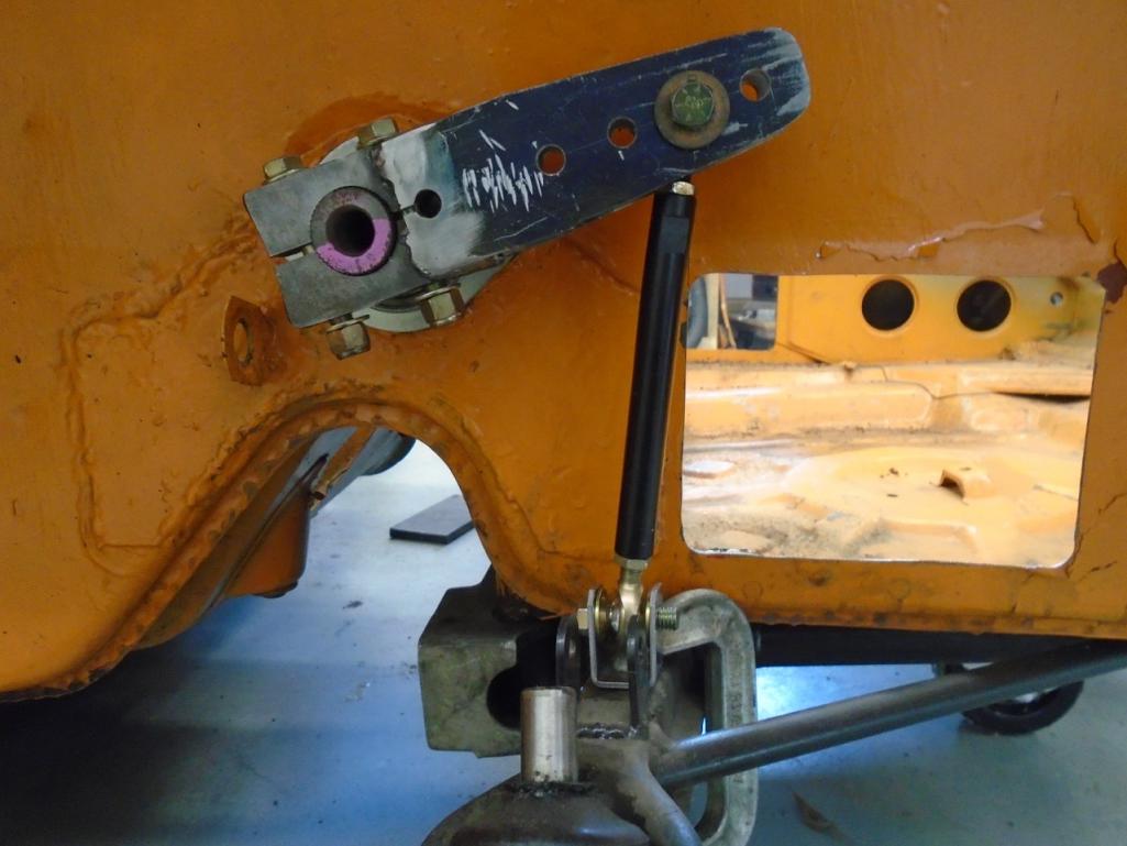

jd74914   Changing the sway bar mounts slightly to accommoda...   Jan 9 2017, 04:30 PM
jd74914   Finished up the sway bar bearing mounts over lunch...   Jan 11 2017, 03:01 PM
tygaboy   LOVE those sway bar bearing mounts! Just beaut...   Jan 11 2017, 03:31 PM
jd74914   LOVE those sway bar bearing mounts! Just beau...   Jan 11 2017, 05:09 PM

jd74914   Haven't gotten too much done in the last few w...   Jan 30 2017, 05:20 PM
jd74914   Framed out the necessary larger holes in the sway ...   Jan 31 2017, 05:25 PM
jd74914   Threw together the first iteration of the front sw...   Jan 31 2017, 06:44 PM
Racer Chris   Anyone have any thoughts? I think I like your ...   Feb 1 2017, 04:10 PM
Andyrew   Very cool design on the sway bar arms. Let me kn...   Feb 1 2017, 01:19 AM
jd74914   Very cool design on the sway bar arms. Let me k...   Feb 1 2017, 03:55 PM
